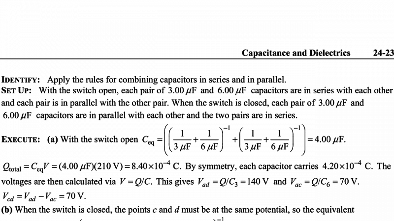

The switch is initially open and the capacitors are uncharged. The applied potential difference Vab = +210V.
a.) What is the potential difference Vcd?
b.) What is the potential difference across each capacitor when the switch is closed?
c.) How much charge flowed through the switch when it was closed?

I can't even visualize what happens when the switch closes, so I'd like to start there. When the switch closes, more current will divert to the bottom capacitor since it will offer less resistance, but my solution manual says it changes the entire circuit setup.
I've attached the problem statement and the solution manual setup statement.
Textbook solution page, section 24-23 Capacitance and Dielectrics, with equations for combining 3.00 µF and 6.00 µF capacitors in series and parallel, giving Ceq = 4.00 µF and voltages across each capacitor.

You do realize that this is a DC setup with capacitors as the load, right? So any current that flows will be a momentary transient while the capacitors charge or change charge to a new steady-state. There are no resistances in the circuit.
Have you worked out the initial voltages and charges on all the capacitors prior to the switch closing? It doesn't make sense to start at part (b) if you haven't established the initial conditions for part (b) to take place.
Okay so, heeding your advice, I solved part (a). I got a potential difference of +70 V from point c to point d.
Now, closing the switch, what happens? I still can't picture it.
You won't picture it until you've labelled the diagram with the charges on each capacitor. I haven't seen your values for those charges.
