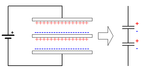

1. How can adjacent pairs behave as individual capacitors?
2. When both switches closed, is it still capacitor?

1. The electric field induces charge separation on intervening plates. The facing plate surfaces act as capacitors.
Schematic of a battery connected to three parallel plates with induced + and - charges on the inner faces, and an arrow leading to an equivalent circuit of two capacitors in series.
2. Yes. But you should draw the equivalent circuit to see what closing S2 does to the circuit. Note that the values of the resistors are unimportant as you're looking for steady-state conditions.

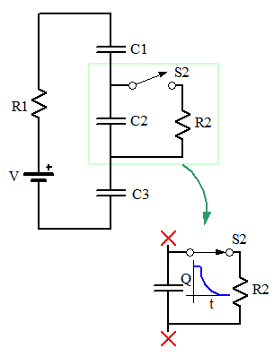

A sufficient time after the switch S2 closes the circuit will reach steady state, and because of the capacitors in the path to the voltage source that means no current flowing (Except for transient activity capacitors block DC current).
Now, the center capacitor has a resistor across it via the closed switch. What does that tell you about the steady state potential and charge on that capacitor?
Circuit schematic with a battery V and resistor R1 on the left, three capacitors C1, C2 and C3 in series on the right, and switch S2 with resistor R2 across C2. A detail box shows a capacitor with resistor R2 and a decaying curve labelled Q against t, with red crosses marking the wrong connections.
Let me try.
The energy stored in the center capacitor will be used up so there is no charge accumulated on the plates of C2. C2 will behave like short circuit so now the circuit consists only two capacitors (C1 and C3) in series?
songoku said:
Let me try.
Well, I'd say that at steady state the potential across C2 will be zero. But essentially you are correct in that C1 and C3 will be the only capacitors holding a charge. So what must be the charge on them?
The total capacitance is C/2, so the value of Q' = C/2 . V and the ratio of Q'/Q will be 3/2
