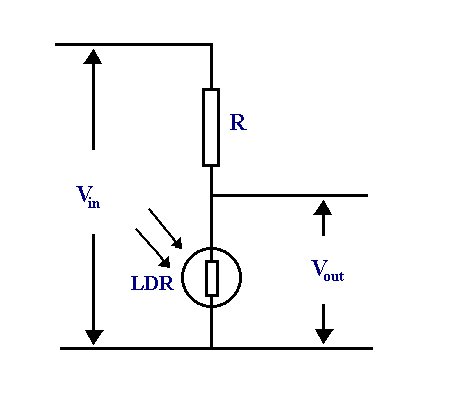

R2 represents anything you put between the Vout terminals. The formula allows you to calculate the effect of R2 with whatever Voltage is applied and whatever value is selected for R1.
The issue is that if R2 represents anything you put in the Vout terminals, the above diagram wouldn't make any sense
What matters is the relationship between R3 and R2 (rather than R3 and R1). R3 won't matter if R3 >> R2. That applies any time you have two resistors in parallel.
If R3 isn't >> R2 then replace R2 in the equation with R2||R3.
Works for the LDR as well.

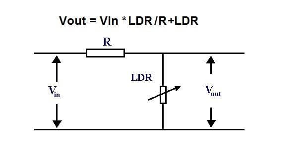

How is this?
