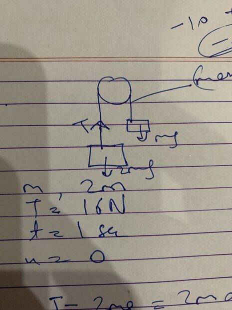

The heavier block in an Atwood machine has a mass twice that of lighter one. The tension in the string is 16N when the system is set into motion. Find the decrease in U(GPE) during the first sec after the system is released from rest.
##F_{net}=ma##
##s=ut+1/2at^2##
##\Delta U=mgh##
##T-2mg=2ma_1## (acceleration of heavier mass)
##T-mg=ma_2##
(##-a_1=a_2##)
On solving the eqns, ##a_1=-g/3=-a_2##
##s=1/2at^2##
##s=-g/6## , distance covered by heavier mass.
##s=g/6## , covered by lighter mass.
Edit: ##\Delta U_1=mgh=-2mg^2/6## (decrease in U of heavier mass)
##\Delta U_2=mgh=mg^2/6## (increase in U of lighter mass)
##\Delta U=\Delta U_1+\Delta U_2=-mg^2/6##
Now what is m?

You have not used all of the information in the problem.
You haven't yet told us what you think it is ! (Or how you arrived at ##\Delta U=-mg^2/6##)

I don’t know m. It’s not given. Also I have edited the post. I thought it’s pretty clear but anyways.

The question should, ideally, state what ##m## is. But the author has assumed it is clear from the information given in the question.
So, as already suggested by @Orodruin and @haruspex, read the question again and take a guess at what you think ##m## is. What is your best guess?
(You can then find ##\Delta U## based on your guess.)
Sorry @rudranch verma. Based on your original (pre-editted) Post #1, I thought you were asking 'what does ##m## represent?
But it looks like you want the value of ##m##. See @Orodruin's and @haruspex's posts.

Got it! 4mg/3=16, m= 1.22 kg
##\Delta U= 19.6 J##
Thank you!
It’s not very clear when is T=16N but I think it’s during motion. That’s how I wrote the eqns.
Why 4mg?
Lnewqban said:
Why 4mg?
Because 1 + 1/3 = 4/3.
