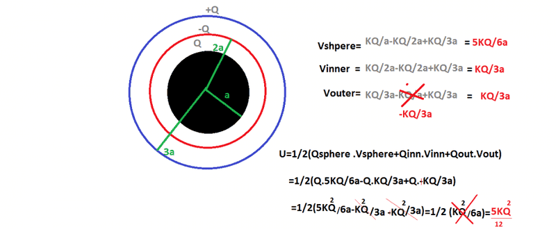

Vouter=potential due to inner sphere+potential due to -Q(charge on the inner surface of outer shell)+potential due to +Q(charge on the outer surface of outer shell)
=##\frac{KQ}{3a}##+##\frac{-KQ}{a}##+##\frac{KQ}{3a}##
why is the potential due to the charge on the inner surface of the shell -KQ/a on the outer surface?

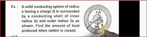

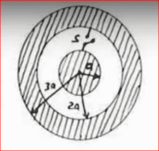

Ok.There is a question.
A solid conducting sphere of radius, a, having a charge, Q, is surrounded by a neutral conducting shell of inner radius, 2a, and outer radius, 3a, as shown.Find the amount of heat produced when a switch connecting the spheres is closed.
gracy said:
I'm assuming that the region between r = 2a and r = 3a is the outer conducting shell.
The potential at the outer surface of the shell is given by ##\displaystyle \ V_\text{outer}=k\frac{Q}{3a} \ ##, assuming that potential → 0 as r → ∞ .
The potential at the inner surface of the shell is the same as ##\displaystyle \ V_\text{outer}\ ##, right ?
Find the potential difference at r = a and r = 2a, due to charge on the solid sphere.
I think it should be ##\frac{-KQ}{3a}##(using shell theorem)
This is correct for the potential created at the outer surface by the negative charge on the inner surface.
##\frac{-KQ}{3a}## it will be potential of outer shell due to charge on inner surface of outer shell .

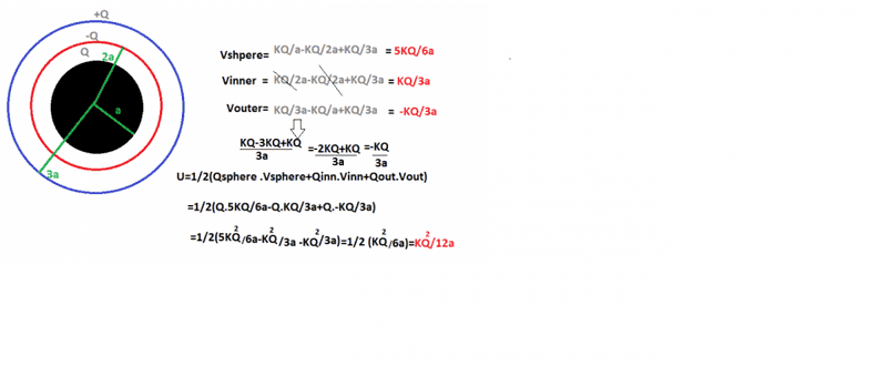

What is the total potential on the outer surface of the shell due to all 3 charge distributions?
Can you use the shell theorem to show that the total potential is the same at all points within the spherical shell material? (Of course this must be the case, since all points of a conductor are at the same potential in electrostatics.)

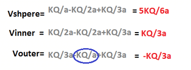

As ehild pointed out, you made a mistake in the term that I have circled in blue below. From post #50, you now have the correct expression for this term. Everything else looks good to me.
  • Three rows of handwritten-style potential sums: Vshpere = KQ/a-KQ/2a+KQ/3a = 5KQ/6a; Vinner = KQ/2a-KQ/2a+KQ/3a = KQ/3a; Vouter = KQ/3a-KQ/a+KQ/3a = -KQ/3a, with the term KQ/a circled in blue.
##\frac{KQ}{3a}##
OK. So, you find that the initial PE of the system is 5kQ2/(12 a).
[You left out the "a" in the denominator, but I know you meant it to be there.]
Why do you think this is wrong?

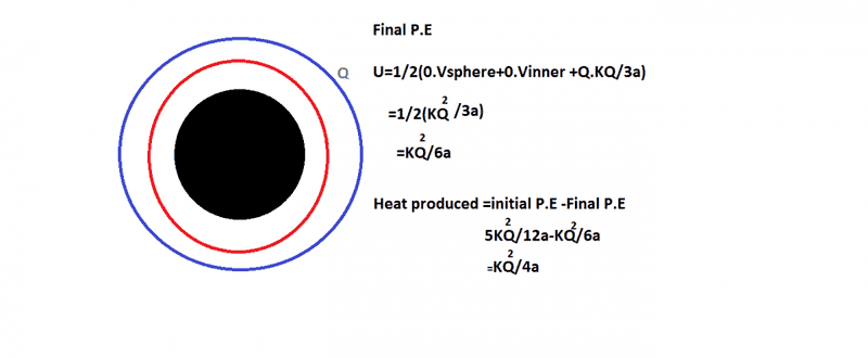

Ok.It was initial energy .
To find the final potential energy we will have to consider final situation i.e after closing switch.
After closing switch entire charge i.e Q will be transferred to outer shell to equate the potentials of inner sphere and outer shell.
Handwritten working on concentric shells: a black inner sphere, a red middle shell and a blue outer shell labelled Q, beside final potential energy and heat produced equations.
The answer I got is indeed a correct answer.Thank you so much @TSny @ehild and @SammyS
