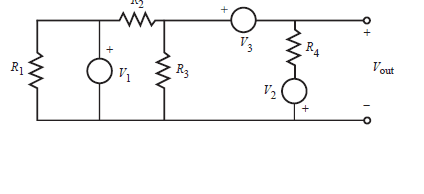

I attached the circuit. I'm trying to solve for V_out, but I'm stuck.
I can solve for it using mesh analysis, but there must be an easier way. I just don't see it yet. Can anyone give me a hint?

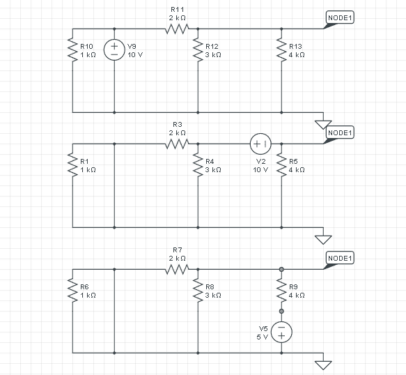

To me simplest seems using the Superposition Theorem.

I used mesh analysis. Can someone verify if my answer at the bottom is correct?
Here's what I did using mesh analysis:
1. For the 3 closed loops, assume each loop has a clockwise current
2. I1 is the left loop's current, I2 is the middle, and I3 is the right
Given:
R1=1000Ω R2=2000Ω R3=3000Ω R4=4000Ω
V1=V3=10V, V2=5V
For loop 1 (left):
-1000*I_1-10=0
-1000*I_1=10
For loop 2 (mid):
10-2000I2-3000I2+3000I3=0
-5000I+3000I3=-10
For loop 3:
-3000I3+3000I2-10-4000I3+5=0
3000I2-7000I3=-5
Putting this in matrix form and solving gives:
I1=-0.01A, I2=2.1mA, I3=1.923*10^-4A
Vout-R4*I3+V2=0
Vout=4000*1.923*10^-4 - 5
= -4.2308V
With the way Vout is drawn, it should be negative right?
Yes, that's correct.
Notice that you didn't need to consider Loop 1 at all.
This was how I did it. Same answer.

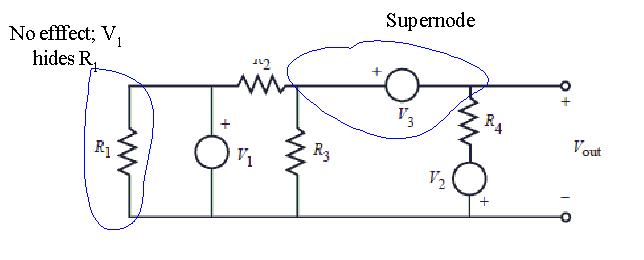

If you recognize that R1 is "hidden" from the rest of the circuit by V1 (and so can be eliminated from the circuit entirely), and that V3 forms a supernode of Vout, you can write a single node equation and solve for Vout.
