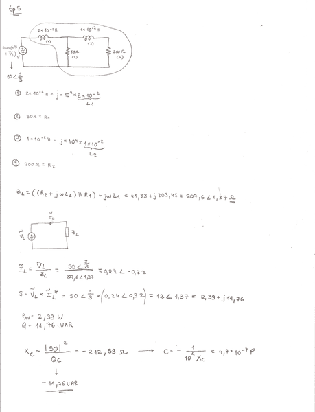

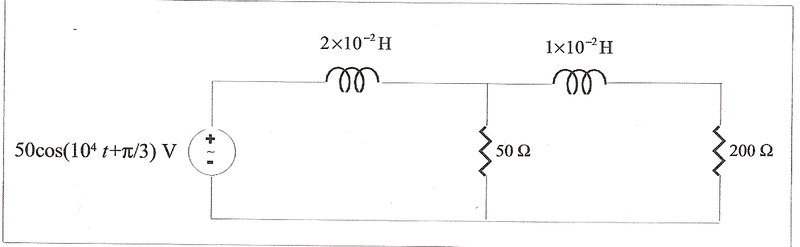

The discussion focuses on calculating complex power in a circuit and correcting the power factor to unity by adding a parallel reactance. Participants confirm the method used for the calculations is correct, emphasizing the importance of understanding complex power and power factor correction techniques. The conversation highlights practical applications of these concepts in electrical engineering and circuit design.
