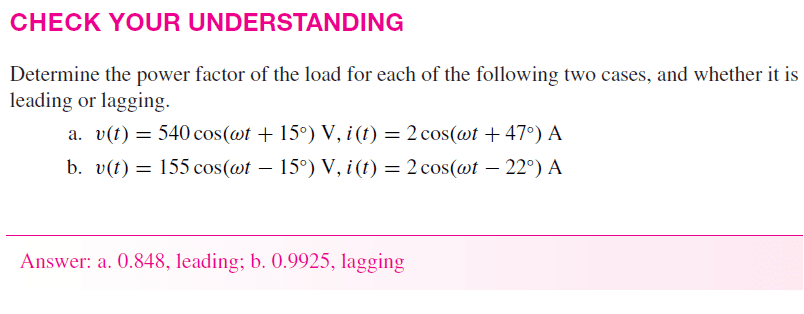

Calculate the power factor for each case:
v(t) = 540 cos(ωt + 15◦) V, i(t) = 2 cos(ωt + 47◦) A
v(t) = 155 cos(ωt − 15◦) V, i(t) = 2 cos(ωt − 22◦) A
Vrms=V/sqrt(2)
Irms=I/sqrt(2)
Textbook exercise titled Check Your Understanding asking for the power factor and leading or lagging status of two loads with given voltage and current cosine expressions; answer key lists a 0.848 leading and b 0.9925 lagging.
My attempt at solving this question:
Handwritten-style worked AC circuit calculation on graph paper: omega = 377, v(t) = 450 cos(omega t + 15 deg), i(t) = 2 cos(omega t + 47 deg), Vrms = 540/sqrt(2) = 381.838, V = 381.838 angle 15 deg, Irms = 1.414, I = 1.414 angle 137 deg, Z = V/I = 270 angle -2.129, Pf = cos(arg(Z)) = -0.53.

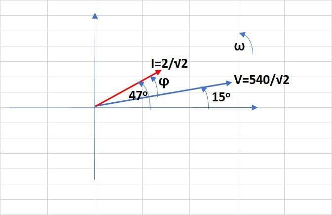

I realized my attempt is wrong however I just don't know how to proceed in the first step. How can I calculate the phase shift? and find Voltage and Current in phasor form??If I know that, then I can use power factor formula: pf=Pav/V*I
The plane in which voltages and currents are represented rotates with ω radians per seconds. The angles between voltages and currents are constant and rotate all the time with the same velocity. Power factor it is the cos(ϕ).

Yeah, I realized I just had to subtract the voltage angle from the current one and take cosine of that. Thank you.

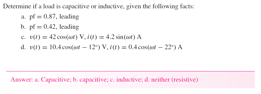

can you also help me with this one pls?
Four AC load problems with answers: a. pf = 0.87 leading; b. pf = 0.42 leading; c. v(t) = 42 cos(wt) V, i(t) = 4.2 sin(wt) A; d. v(t) = 10.4 cos(wt - 12°) V, i(t) = 0.4 cos(wt - 22°) A. Answer: a and b capacitive, c inductive, d neither (resistive).

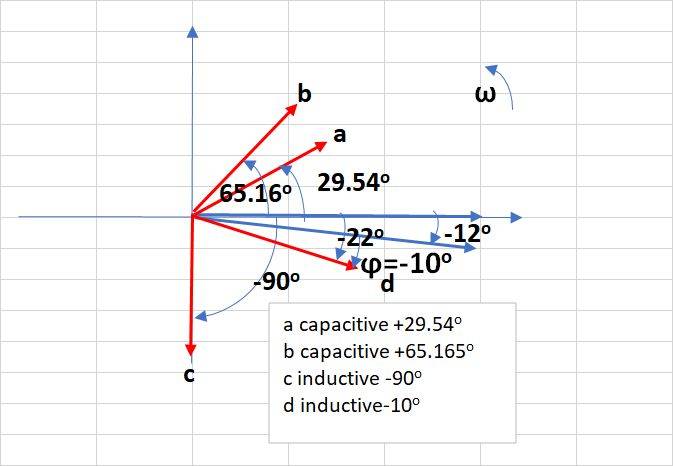

I understand that the first 2 are capacitive as power factors are leading. In C, I think I understand why it's inductive because first if we change current equation to cosine, then: i(t)=4.2 sin(ωt-(pi/2)), and the phase angle is 0-(-pi/2)=pi/2, and positive phase angle indicates that the load is inductive. If that reasoning is true, then d, should i also be inductive, but it is resistive. I thought the phase angle has to be for the load to be resistive.
You are right.
  • Phasor diagram with arrows from a common origin: red arrows a at 29.54°, b at 65.165° (both capacitive), c at -90° (inductive), and d at -10° (inductive); blue arrows show angles -12°, -22°, the phase angle φ = -10°, and rotation direction ω.
