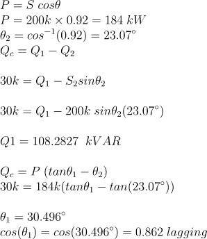

The power factor of a certain load is improved to 0.92 lagging with the addition of a 30 kVAR bank of capacitors. If the resulting supply apparent power is 200 kVA, determine the power factor before correction.
Attached below.
Relevant Equations:
My solution:
Could someone please verify my answer?
