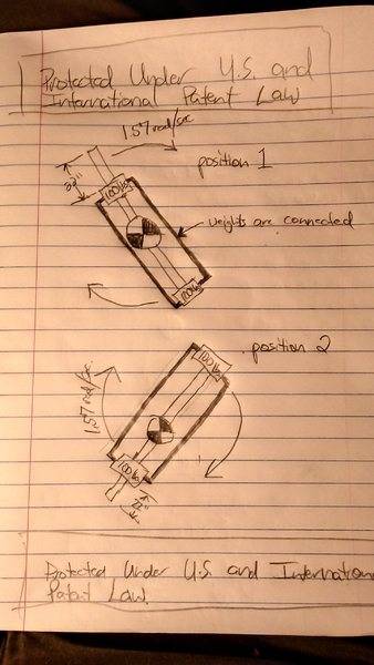

Yes. There are centripetal forces at work here as well. So as the the weight is being lifted vertically, its also rotating at a rate of 1.57 rad/sec around a common center point or axle. I know its a little confusing. See attachment please.
You'll need to add some description to that.
It looks like two masses of 100lb on an arm rotating at a steady rate in ... a vertical plane?
One mass is 22" closer to the axis than the other? But we do not know how long the arm is?
Two positions are shown, but no angle specified.
How did the mass become 250lb? Does the arm have mass 50lb?
This being so, I do not understand how the distance moved becomes 22", nor why the thread title says a mass is being lifted vertically.
Please provide a clear statement of the problem.
That drawing appears to show two 100lb weights = 200lbs not 250lbs.
It also doesn't show the 392lb applied force, where it acts or the direction in which it acts.
Yes, you are correct, it is rotating 360 degrees in a vertical plane. Much like a windmill or ferris wheel. The weight became 250 because the connecting rods that join the 100 pound weights are around 50 lb. So you have the two 100-pound masses and then another 50 lb in the connecting rods. The overall length of the arm is 10 ft. The two, 100lb masses make a vertical transition 22 in between the 11 o clock position and the 1 o'clock position. Takes around one second to make that part of the rotation.
The 392 pound force is created by a electric linear actuator which is hard mounted to the back side of one of the 100-pound Masses.
I cannot relate that to the diagram. 11 o'clock to 1 o'clock would only be a rotation of 60 degrees. The diagram seems to show (depending on which end of the arm is considered the "hour hand") either 11 o'clock to 7 o'clock or 5 o'clock to 1 o'clock, a rotation of 240 degrees.
Either way, I do not see how that equates to lifting 200 pounds (certainly not 250 pounds since the arms do not lift) through 22". That would involve a rotation from, say, 6 o'clock to 12 o'clock.
They can't move vertically because the rig rotates while they move. Do you mean the weights slide along the central rod 22" while the angle of the rod changes?

I think you also need to reword the question because it's clear the weights aren't simply being lifted vertically. I think it will be difficult to analyse what's going on. You would need to know things like...
The exact force profile produced by the solenoid as I doubt it is constant. The figure you quoted is just the makers figure right?
The instantaneous angular velocity immediately before and after the "lift".
I suppose then you could calculate the energy input via the solenoid and compare it with the energy added to the wheel. However I would need a very good reason why I should put in a lot of effort to do so.
