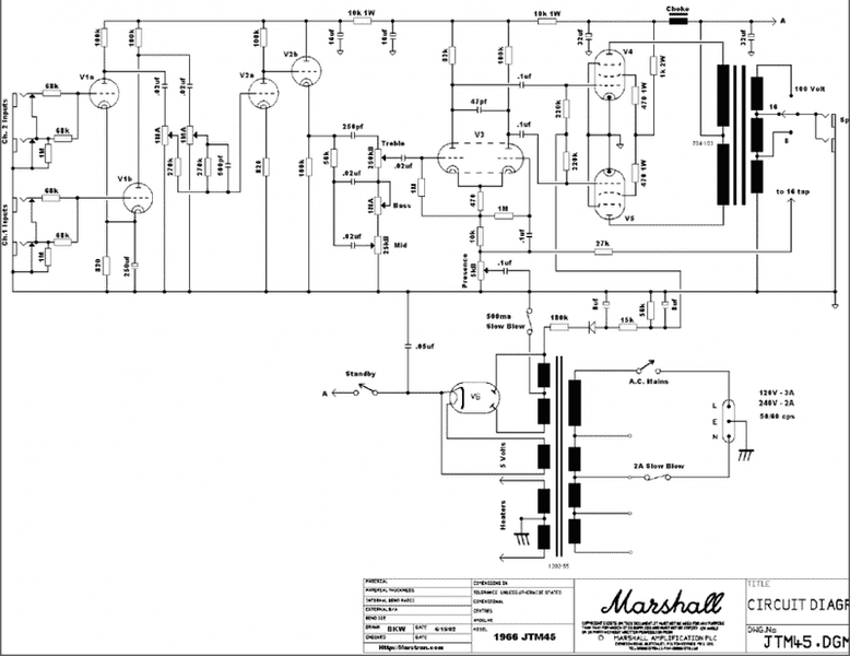

Hi guys,
Here is the amp schematic, http://www.classictubeamps.com/schematics/Marshall/1966%20JTM45.pdf
Here is the power supply schematic I would like to modify and use.
http://imgur.com/a/sdYAV
I don't know how to get both of these schematics to display in this post...I guess I will never make it as a computer guy..lol
Do you see any issues with this idea?
Cheers,
Billy

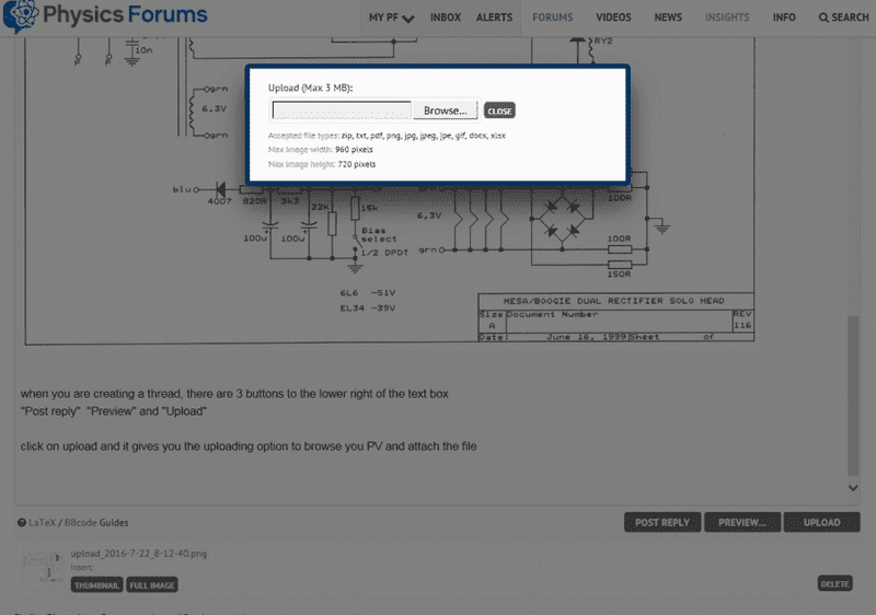

when you are creating a thread, there are 3 buttons to the lower right of the text box
"Post reply" "Preview" and "Upload"
click on upload and it gives you the uploading option to browse you PC and attach the file
hope that helpscheers

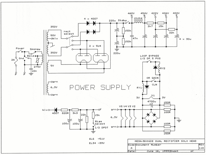

Now it will be easy to talk about the schematic. Anyway the idea is to use a twin rectifier and a switchable solid state power supply for the JTM45 amp. I don't understand the primary side of the transformer on the Mesa schematic.
The "Spongy" position reduces the supply voltages to the amp by changing the transformer turns ratio. This reduces the peak output power and may change the distortion characteristics a little due to the reduced filament voltages.
If you use the identical power transformer, it should work. Original power transformer for two reasons:
1) The dual 5U4 rectifiers draw 6Amps filament current and most xformers assume a single 5U4 at 3Amps.
2) There is a minimum recommended transformer resistance for 'reasonable' 5U4 life. This limits the peak plate current of the tube.
For 5U4 data sheets and design hints see:
https://frank.pocnet.net/sheets/049/5/5U4GB.pdf
http://www.theremin.us/Rockmore Theremin/5U4G.pdf
To equalize the reverse voltages across the 1N4007 diodes, I recommend a 1Meg 1/2W resistor in parallel with each diode.
Realize that the various supply voltages, 422V, 406V, 402V, will depend on the current drawn from each voltage; but they are not likely to be critical.
