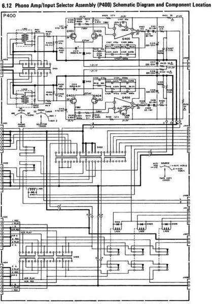

Hi,
I repaired this amp and have everything working except one channel of the phono input. The left channel works fine.
Any ideas of how to troubleshoot this issue?

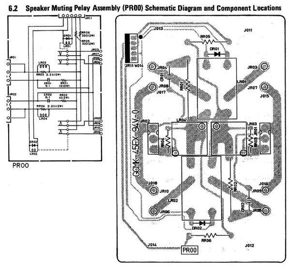

The part of the schematic in question is 6.2 Phono Amp Input Sclection...I know..PITB..lol
Figure 6.2 is Speaker Muting.

Figure 6.12 on pg.13 is Phono pre-amp schematic. Test points A and C, at right edge of schematic near J410, are outputs of the pre-amps; a good place to start signal trace or signal inject. The pre-amp inputs are J405 at the left edge of the schematic, another good place to inject a signal. Good luck tracing thru all those switches and relays!

I don't think I have ever tried to work on a phono issue. I assume I can safely inject a signal of only less than 2 mV. I will be lucky if the fault is at or before the op-amp.
There are Alps rotary switches that connect via a plastic flat cable with a metal strip encased in the center of the cable that actuate a slider switch. I don't assume at the moment that they are the issue. There are no numbers on the switches, just Alps/Japan. I have no idea if they can be bought or how to identify them. Also the signal inters a small transformer which has no part numbers (well..it has a Marantz part number on the schematic)...lets hope the issue is not there!
I don't typically try to repair vintage solid state stereo and what little experience I have has been pretty frustrating. I need to replace certain capacitors in this unit for example which are no longer made. How to re-design something using parts that are currently available is more or less pushing the limits of the skills I currently have.
I see the test points you refer to...thanks for pointing them out. I will start there.

EDIT: I found part of the issue at least. The Alps switch (S401) is not working correctly. No signal from the switch to the right side transformer. Digikey and Mouser do not sell them. Arrow.com sells Alps but nothing like what I need.
