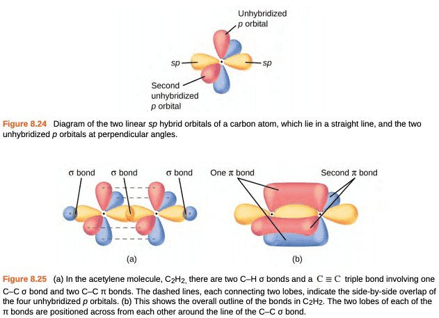

Consider an ##N_2## molecule. Chemists say that the triple bond is due to one ##p_x - p_x## overlap, one ##p_y - p_y## overlap and one ##p_z - p_z## overlap. The x-axis (the label is not important; I’m sure you know what I mean) is clear because it’s the longitudinal axis of the molecule. But how do you know what the directions of y and z axes in the physical world are?
Also, since any linear combination of ##p_y## and ##p_z## is also a solution to Schrödinger equation, how do you know the electrons are not in this kind of state? Why must they be purely in ##p_y## or ##p_z##? (Suppose you believe the chemists are right.)
Are the electrons purely in ##p_y## and ##p_z##? ##p_y## and ##p_z## are pointing in some definite direction in space, it’s just that those definite directions are unknown to us. Or are the electrons in a linear combination of ##p_y## and ##p_z## such that their orbital looks like a cylindrical shell surrounding the x axis? (Like a toilet paper roll with uniform probability amplitude all over the curved surface.)
If you measure the orbitals along some axis then you'll get a result based on that measurement, but if you don't then there is no preferred direction of the molecule.

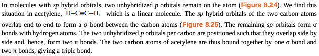

https://web.ung.edu/media/Chemistry2/Chemistry-LR.pdf

So there's an answer to your question in the OP:
You defined the ##x## axis as along the line between the two carbon atoms. The ##y## axis is then the direction perpendicular to that in the plane of the molecule, and the ##z## axis is the direction perpendicular to that plane.
For acetylene, which is linear and therefore does not pick out any particular direction perpendicular to ##x##, the best way to visualize it is the "space-filling model" image in figure 9.20.6. Note that that image is symmetric about the ##x## axis, i.e., it picks out no preferred direction perpendicular to that axis. In other words, when sources talk about "y" and "z" directions for such cases, they're being somewhat sloppy.
The space-filling model is not depicting the shape of the electron orbitals! It's only for showing the general shape of a molecule as though all its atoms are spherical in shape, and so it's not realistic, though it can be used as a good approximation to the realistic shape of a molecule. In other words, it always treats atoms as spheres even when their electron orbitals are not spherical, which is the case for ##N_2## with its ##p## orbitals. https://en.wikipedia.org/wiki/Space-filling_model
So with this understanding, you can see that the reference https://chem.libretexts.org/Bookshelves/Introductory_Chemistry/Book:_Introductory_Chemistry_(CK-12)/09:_Covalent_Bonding/9.20:_Sigma_and_Pi_Bonds
is not saying that the molecule is symmetrical about the x axis. It is saying there is a preferred direction for the sideway overlap of the ##p## orbitals, namely above and above the "plane" of the molecule, just like Figure 8.25(b).

That sentence (ie., these side-to-side overlaps are above and below the plane of the molecule) was talking about ethene, which can't be compared to ##N_2##. Ethyne—but not ethene—can be compared to ##N_2##. In ethene, its 4 H atoms form a plane, destroying the cylindrical symmetry along the x axis, which exists in ethyne and ##N_2##.
True, but in the case under discussion it's a better visualization than the one you are trying to use. See below.
And as I said, when references seem to be saying that in such cases, they are being sloppy. You yourself can see why: because for a linear molecule, like N2 or C2H2, no particular direction perpendicular to the line of the molecule is picked out. So in the absence of any measurement perpendicular to the line of the molecule (and there isn't any such measurement for molecules in, say, nitrogen gas in the Earth's atmosphere or acetylene in a tank supplying a welding torch), the state of the molecule will be axially symmetric.
