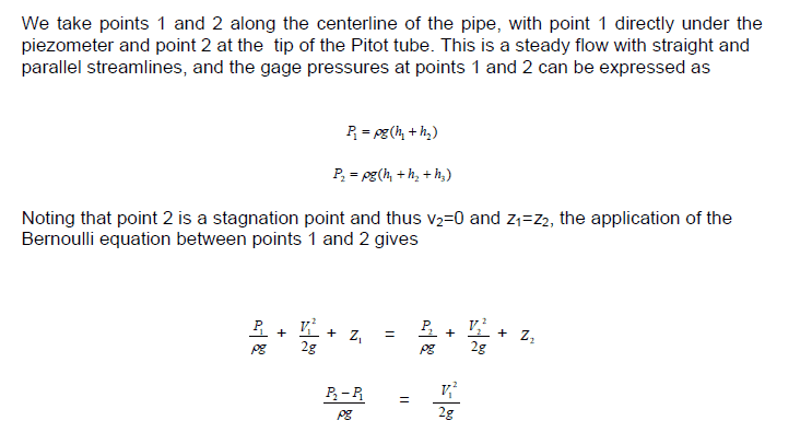

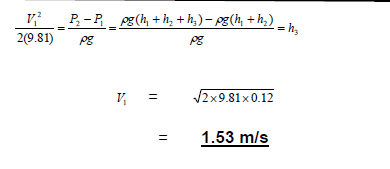

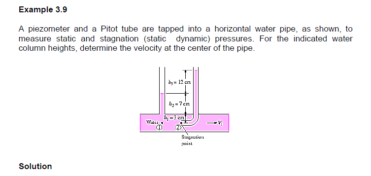

werson tan
183
isn't that p1 and [2 at the same point ? why shouldn't the P1 = P2 , which is
ρg(h1 +h2 +h3) ?

The velocity of the liquid makes a difference! Bernoulli.

BvU means you must apply the Bernoulli equation to the two points to find out what the pressures are at those locations.
When the fluid is in motion, the pressure at any point is no longer equal to just the static pressure.

This is almost comical: 0084.png in post #1 says it all but apparently isn't acceptable for Werson. Do you find it difficult to understand the term with ##v^2## in the Bernoulli equation ?

This would be correct if that expression were set equal to a constant, and if that 0.2 in the denominator were a 2. Do you agree?

Let's try to apply the Bernoulli equation to P1 and P2 to see what it tells us about their relationship. But, before doing that, do you understand the Bernoulli equation? Also, precisely what does z represent in the Bernoulli equation?

You should think of z more as the elevation above a specified datum z = 0. In this problem, a logical choice for the datum would be the center of the pipe. Now please articulate what the Bernoulli equation means to you, or what each of the terms in the equation means physically.
