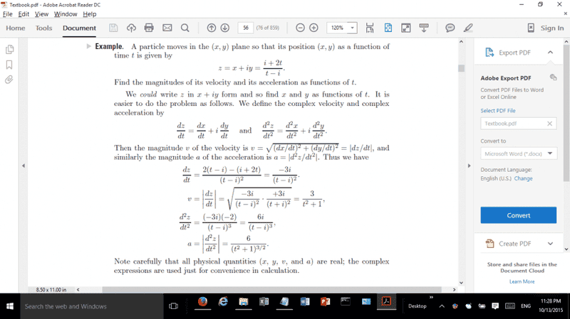

Textbook page showing a worked example of a particle moving in the (x, y) plane, with z = x + iy = (i + 2t)/(t - i), followed by derivatives dz/dt and d²z/dt², and the resulting speed v = 3/(t² + 1) and acceleration a = 6/(t² + 1)^(3/2).
see above
After getting ##v = |\frac{dz}{dt}|=\frac{3}{t^2+1}## why can't I simply take the derivative of that with respect to ##t## to get the acceleration?

The notation is a little weird. What they're calling v is actually the magnitude of the velocity, not the velocity itself, and ##\frac{dz}{dt}## is the velocity. To get the acceleration, you need to differentiate the velocity (not its magnitude) with respect to t.
Okay, so simply put the derivative of the magnitude of velocity is not the magnitude of acceleration? ##\frac{d}{dt}(|\frac{dz}{dt}|)\neq|\frac{d^2 z}{dt^2}|##

But the question asks for the magnitude of acceleration
Right, but they first have to get the acceleration, and then get its magnitude.
