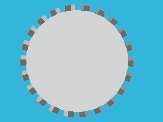

Hello.
I've come up with an idea that I need to check:
There is a wheel, filled up with air, inmersed on a tank of water.
Attached to that wheel there is a number of boxes, that has two windows on opposite sides that can communicate with the water on the tank, or with the air inside the wheel.
Inside these boxes, there is a heavy plunger that keeps the water and air appart, and falls down to the bottom of the box due to gravity.
When it opens the window to the water, closes the air window, and viceversa.
So all the plungers on one side of the wheel closes the air window, and the plungers on the other side closes the water one.
So on one side of the wheel all the boxes are filled up with water, and on the other side all the boxes are filled up with air.
This represents a difference on forces, because the boxes filled up with air have a quantity of thrust, and the boxes with water have an adittional weight that the other boxes does not.
So you can see that the wheel have different forces on each side, due to the plungers falling down to the bottom of the boxes by their own weight, and letting the boxes on one side fill with air, and the other side of the wheel fill with water, as the wheel rotates... and you can see that this imbalance is always there (it doesn't matter that the wheel is spinning), and in fact, is this imbalance what is causing the rotation of the wheel...
So where is the error here?
I post an animation to clarify how it is supposed to work...

Also, I'm not saying that the air boxes floats on the water and rise up... I'm just telling that the resultant on one side is less than on the other, so it doesn't matter if all the boxes shrink or float... the only thing that matters is that the two sides of the wheel are not in balance.
Hi, Cala.
Even in an ideal situation, with no friction or viscosity losses, the best that you could possibly do is break even. The instant that you try to extract any useful energy from the system, such as by attaching a pulley to run something, you lose.

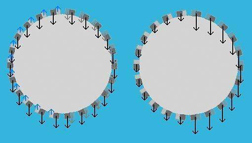

I post a picture of the forces as I see them, and the (more or less) resultant force, and imbalance on the torque.
There are only two things that I see could go against the movement:
- When the bottom box pass from be filled with water to be filled with air... Can the plunger (taking into account that is much heavier than the water) move the water outside the box? I think it is, but maybe I'm wrong...
- The other moment that could avoid the wheel from spinning is when two boxes are on top and bottom of the wheel. In this situation, the two plungers of this boxes are on one side of the wheel... Could this extra weight compensate the imabalance?. I think that they can't, because there are a lot of other weights opposing (so maybe in this case, the imbalance is less than on other positions, but still it works).
I would appreciate if you explain this better, or have other ideas on what could stop the device turning forever.
  • Two circular arrangements of grey boxes with downward black arrows and blue and grey arrows around the rims, on a blue background; a large grey disc sits at the centre of each.
If the plunger can push water outside the box, then it can also push air outside the box- where it escapes. So the next time the plunger pushes the water out of the box, where does the air to fill it come from?
