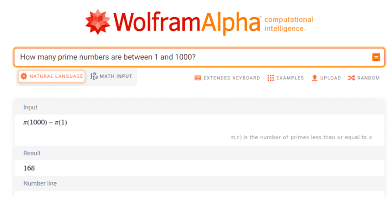

There are 168 prime numbers between 1 to 1000, 16.8% and 303 prime numbers between 1 to 2000, 15.15%.

There are 168 prime numbers between 1 to 1000, 16.8%. So I assume the distribution becomes sparse for larger number region.
