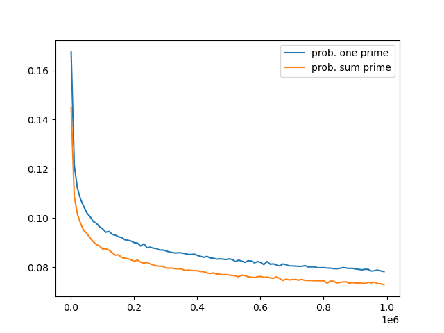

I would think that the probability that the sum of a pair of randomly selected integers between ##n## and ##m## is prime would be a little smaller than the probability that an integer selected randomly between ##n## and ##m## will be prime. Because the expected value of the sum is larger, and the ratio of primes to integers decreases as the numbers get larger.
Here is a program you can use to try and test it:
Python:
import sympy
import random
n = 1
m = 100000000
N_ITER = 10000000
n_sum_primes = 0
n_single_primes = 0
for i in range( N_ITER ):
    p1 = random.randint( n, m )
    p2 = random.randint( n, m )
    if( sympy.isprime( p1 ) ) :
        n_single_primes += 1
    if( sympy.isprime( p1 + p2 ) ) :
        n_sum_primes += 1
print( n_sum_primes / N_ITER )
print( n_single_primes / N_ITER )
Going up to 1 million the probabilities look like this:
