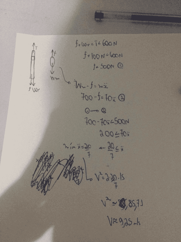

THe tension, W = mg and F =ma
I thought in this equations
f is the man's pull\
f + dm*g = T < 600
Where dm is equal to the mass of the string that pull the up part (15-x) after descending x meters.
dm/(15-x) = m/15
And, to the man: W - f = Mx''
I can solve this, and i got ~8m/s
Is this right?
Doesn't all of the rope pull on the top of the rope constantly?

I think that is what @LCSphysicist intended to do, but only considered the tension immediately above the prisoner at any point, so omitted the weight of the rope above the prisoner.
You are right, now i got nine ~9,2m/s something like this, don't remember now, and since the answer is 9m/s, maybe is right
I get 9.2582m/s all this stems from that the maximum pulling force of the prisoner is 500N. Also I took g=10m/s^2 in my calculations.
Could you show your work?
For some reason, my calculations differ.
Perhaps I am seeing the problem incorrectly:
The hook is holding the dead weight of the rope (10 Kg x g).
The prisoner stands on the window (his initial velocity equals zero) and jumps out.
While he falls, he holds the rope not tightly enough to slowdown much or stop (which would break the hook) but not loose enough to hit the ground too fast.
By doing so, he "selects" a maximum falling constant acceleration (resulting from the balance between the weight and the hands-rope-friction forces), which value is less than g but greater than the maximum permissible by the strength of the hook.

"By doing so, he "selects" a maximum falling constant acceleration"
I think he sellect a minimum acceleration, so he will come to the ground with the minimum velocity possible, and, to do this, he needs to pull the rope with the maximum force that the rope can support without breaking.
So the force need to be maximum, to the acceleration be minimum. {this force will retard his free falling}
