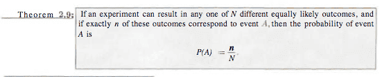

I am getting a little confused as to whether to use the number of permutations or the number of combinations as my sample space when it comes to probability problems, or whether it depends on the situation. Let's look at two of the examples from my text to help:
Example 1:
In the above example, they are using the following formula to determine the sample space:
and thus the sample space consists of distinct combinations.Example 2:
In this example it looks like they are using permutations as the sample space since, for example, elements THH and HHT are not distinct. I will also include the definition of probability, since I think that it might help me clear the confusion:
Any thought on this one?
~Casey

I haven't read the entire thread, but it seems that vela is just using this to count the number of ways that the player can lose. When all else fails, try to use P(event) = #(ways event occurs)/#(total possibilities).

If you get one head, then one out of the three coins is a head. The number of different ways for this to occur is the number of ways for you to pick one coin (picking the coin to be heads). Then the number of ways for there to be two heads is the number of different ways for you to pick two coins, which will be the two heads.
All I'm doing at this point is counting. There's no probability, there's no chance of having zero heads yet because all I've done is count the number of ways for there to be one head, and the number of ways for there to be two heads.
Now for the probability part: There are 6 ways to get one head or two heads, and there are 8 total possibilities for the three coin flips, each with the same chance. So there is a 6/8 chance that you get one or two heads
