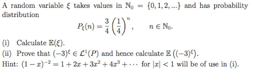

Carla1985
91
I'm stuck on this question. I've done plenty of the questions with numbers etc but not sure how to deal with the n case for this one.
Thank you :)
Thank you :)
If the discrete p.d.f. is...
$\displaystyle P \{ \xi = n \} = \frac{3}{4}\ (\frac{1}{4})^{n}$ (1)
... then, tacking into account that is...
$\displaystyle \sum_{n=0}^{\infty} n\ x^{n} = \frac{x} {(1-x)^{2}}$ (2)
... You obtain...
$\displaystyle E \{ \xi \} = \frac{3}{4}\ \sum_{n=0}^{\infty} n\ (\frac{1}{4})^{n} = \frac{\frac{3}{4}\ \frac{1}{4}}{(\frac{3}{4})^{2}} = \frac{1}{3}$ (3)
Regarding (ii) by definition is...
$\displaystyle E \{ (-3)^{\xi} \} = \frac{3}{4}\ \sum_{n=0}^{\infty} (-3)^{n}\ (\frac{1}{4})^{n} = \frac{3}{4} \frac{1}{1+\frac{3}{4}} = \frac{3}{7}$ (4)Kind regards$\chi$ $\sigma$
chisigma said:
... You obtain...
$\displaystyle E \{ \xi \} = \frac{3}{4}\ \sum_{n=0}^{\infty} n\ (\frac{1}{4})^{n} = \frac{\frac{3}{4}}{(\frac{3}{4})^{2}} = \frac{4}{3}$ (3)
Im confused by this part. If i use the series from the line above taking x to be 1/4 isn't it 1/4 on top instead of 3/4? or have i missed something?
Thanks for the help x
All right!... the mistake has been corrected... thak You very much!...
Kind regards
$\chi$ $\sigma$
Thats fab, thanks very much for the help x
