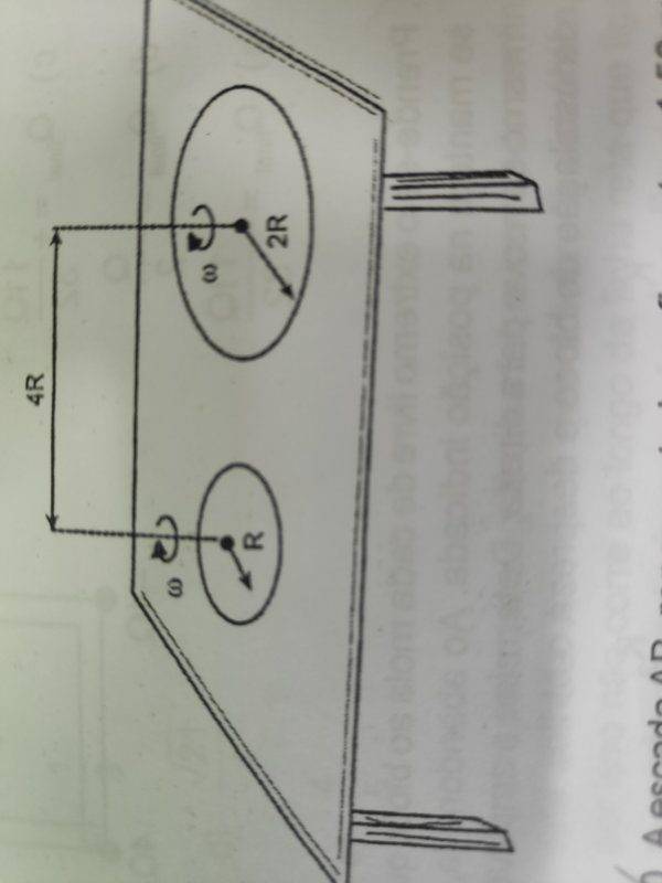

There are two discks rotating with angular velocity w and with radius R and 2R. The distance from there centres is 4R. Find the probability of a particle, that was rotating on the board of the smaller disck, to shock with the bigger after it leaves de disck.
V=wr , P(E)=N(E)/U
There are two points of the smaller disck such that a line is tangent to the two discks and passes by that point. If the particle leaves of any point belongin to the arch that connects these two points, then it will hit the other disck. So I managed to calculate the value of this arch and divide it by 2π. But I got the wrong answer. Is this correct ?
  • Diagram of two rotating discs mounted on a board, the smaller of radius R and the larger of radius 2R, centres 4R apart, each marked with an angular velocity arrow labelled ω.

[edit] by the way, is this happening in the vertical plane ? Or did you just rotate the picture to annoy us ?
So far so good, but what value did you calculate for the arc length?

The movement is in the horizontal plane, sorry about the image.
:smile: I understood that -- I was just being a bit ironic.

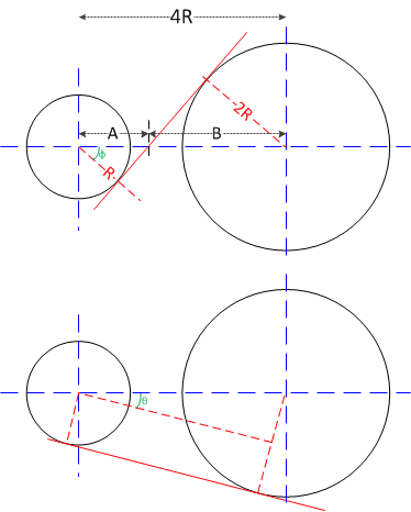

Geometric diagram of two circles on a horizontal dashed axis: a small circle on the left and a large circle on the right, with labels 4R, A, B, 2R, R and angle theta, and tangent lines drawn between them; a lower panel shows the common tangent line touching both circles.
( I did however use the wrong sign for ##\omega## :wink: )
I would like to make a further suggestion to the OP. Make a drawing of the system by hand using a compass and ruled straightedge. You can easily look for similar triangles, equal angles and trigonometric relations which are key to solving this problem and quickly check your answer for sanity. Computer drawing programs are nice but the effort in learning to use them can be time consuming and distract from the problem at hand.
