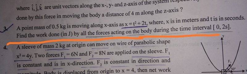

See question number 3

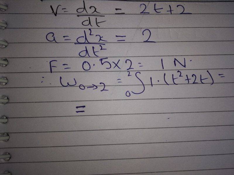

Work Done="integral" F*ds
I tried to solve this question using integration,
I have replaced F with "1" and ds with "t^2+2t".
So I am stuck in at that step.
Please help me differentiate it further or solve it further!
I will be thankful for any help!

In the integral it’s ##F*ds## which becomes ##F*dx## so you can’t just sub in the ##t^2+2t## term.
##dx/dt = 2t+2## and so ##dx = (2t+2)dt##
Thanks for the reply!
But can you please explain why is it wrong to substitute "t^2+2t" in place of ds?
You are not given ds (or dx)= t2+2t; you are given x=t2+2t. So what does dx equal?
