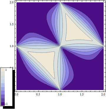

I plot a Contour plot from a function with mathematica, but I don't know how can I add a small box near my figure that explain which value refer to which color?
I put my code below, please help me with adding colordata to my code for having reference for colors.

Needs["PlotLegends`"]
ShowLegend[
 ContourPlot[(3 (2 + m t (4 + m t)) - 4 (1 + m t) Cos[\[Pi] x] -
     2 Cos[2 \[Pi] x] - 4 (1 + m t) Cos[\[Pi] y] - 2 Cos[2 \[Pi] y] +
     4 Cos[\[Pi] (-x + y)] - 4 (1 + m t) Cos[\[Pi] (x + y)] -
     2 Cos[2 \[Pi] (x + y)] + 4 Cos[\[Pi] (2 x + y)] +
     4 Cos[\[Pi] (x + 2 y)])/(m (6 + m t (6 + m t) -
       2 Cos[2 \[Pi] x] - 2 Cos[2 \[Pi] y] -
       2 Cos[2 \[Pi] (x + y)])), {x, 0, 2}, {y, 0,
   2}], {ColorData["LakeColors"][1 - #1] &, 10, " 1", "-1"}]
thank you but how you can understand that you must put 1 to -1 for that range? I don't Know how to estimate the range of color data?
thanks a lot
Well, I haven't estimated it also, just did it as an example. Do a little research :)
how can I put "PlotLegends -> Automatic" in CountorPlot?
I search google but I couldn't find anything suitable for the above code ! Iwant mathematica to find plotlegend in an automatic way, not by writing for example 1 to -1
thanks
In[1]:= t = 0.01;
m = 0.7820;
2 Cos[2 \[Pi] (x + y)])), {x, 0, 2}, {y, 0, 2},
PlotLegends -> Automatic]
Out[3]= ...PlotWithLegendSnipped...
works for me, at least for this example in version 9.

thanks but I have mathematica 7 and when I type that code, it gives error that unknown plotlegends in contourplot ! however, I write : needs"plotlegends'" too.
If anyone is not using the current version of software then it would be really helpful if they made sure to explain that when they ask their question. That will allow people to see if they can think of any workarounds that would be backward compatible with your version when they try to give answers.
What if you use one of the available functions to estimate the minimum and maximum values that your function has inside the plot range you are going to display and use those values to define the upper and lower bounds of your PlotLegends?
