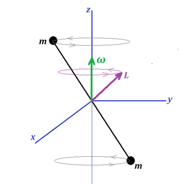

For a given coordinate system, the components ##I_{xx}, I_{xy}, ## etc. of the inertia tensor depend on the orientation of the rigid body relative to the coordinate axes. So, if the body is rotating such that the mass distribution of the body changes relative to the coordinate axes, at least some of the tensor components will change with time.
However, if you choose axes that are fixed to the body (so the axes rotate with the body), then the components of the inertia tensor relative to these axes will be time independent.
For example, consider a "tilted dumbbell" rotating about the z-axis with constant angular velocity ##\boldsymbol{\omega}## as shown:
Diagram of a tilted dumbbell of two masses m on a rod through the origin, spinning about the vertical z-axis with angular velocity ω (green arrow up). The angular momentum L (purple arrow) is tilted off the z-axis, with circular arrows showing precession about z.
##\boldsymbol L## is the angular momentum of the dumbbell and ##\boldsymbol L## precesses around the z-axis. If the xyz axes are fixed in the lab, then all the inertia tensor components relative to these axes will change with time (except for ##I_{zz}##).
But, if we fix the blue coordinate axes to be the dumbbell so that the coordinate system rotates around the z-axis with the dumbbell, all of the inertia tensor components relative to this body-fixed coordinate system will be time independent.

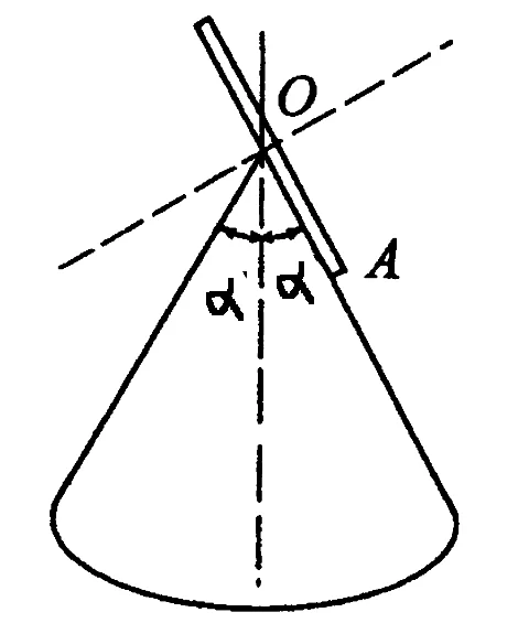

OK, solve the following problem without pseudovectors and show me a gain from the bi-vector's language usage.
A coin of radius ##r## rolls about a cone without slipping. At a moment ##t=t_0## the value of acceleration of the coin's lowest point ##A## is given: ##a=|\boldsymbol a_A|##. Find the velocity of the point that lies on the coin's rim at the horizontal diameter.
  • Diagram of a coin rolling without slipping on the inside of a cone, with the cone's axis drawn dashed, the half-apex angle marked alpha, and points O at the coin's centre and A at its lowest point.
