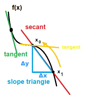

I read your question as the process that uses secants to approach a tangent.
The point where the tangent is drawn is the instantaneous velocity, and the slope of the secant is the average velocity. If you let ##x_1## approach ##x_0,## which are moments in time, you finally receive the (yellow) tangent at ##x_0.## In this sense, the average (red secants) approaches the instantaneous (yellow tangent) velocity.
The mathematical background is the definition of differentiability. If the velocity curve ##f(x)## (speed at a certain point in time) is differentiable, then you can write
f(x_0+a)=f(x_0)+f'(x_0)\cdot a + r(a)
where ##a## is a very short timespan that can be arbitrarily short. The other terms mean:
\begin{align*}
f(x_0+a)\quad&\text{instantaneous velocity at time } x_0+a\\
f(x_0)\quad&\text{instantaneous velocity at time } x_0\\
f'(x_0)\cdot a\quad&\text{average velocity measured measured during } a\\
r(a)\quad&\text{very small correction term}\\
\end{align*}
##f'(x_0)## is the slope of the tangent at ##x_0## (instantaneous velocity) derived from the slope of the secants ##\dfrac{f(x_0+a)-f(x_0)}{a}## (average velocity during ##a##). The descriptions you mentioned try to describe this formula without using it.
