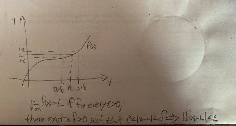

Handwritten sketch of a curve f(x) approaching height L near x = a, with horizontal lines at L+ε and L−ε and vertical lines at a−δ and a+δ; below it, the epsilon-delta definition: lim as x→a of f(x) = L iff for every ε>0 there exists δ>0 such that 0<|x−a|<δ implies |f(x)−L|<ε.
I find the picture usually helps.
