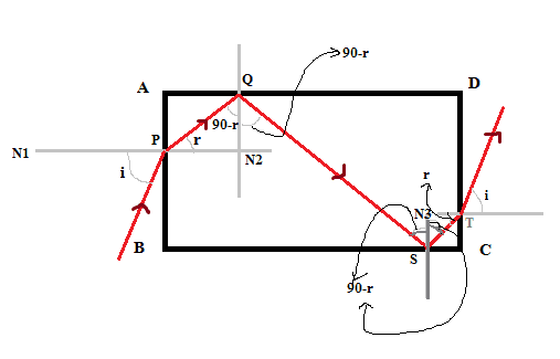

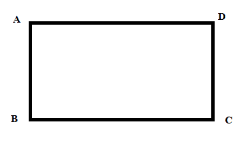

Light falls on the surface AB of a rectangular slab from air. Determine the smallest refractive index n that the material of the slab can have so that all incident light emerges from the opposite face CD.
Let's think about this case:
There must be total internal reflection at Q and S.
That means, ##90-r>\theta _c## [##\theta _c## is the critical angle]
## sin(90-r)>sin \theta _c##
##cos r > \frac{1}{n}## [## sin \theta _c = \frac {1}{n}##]
##n>sec(r)##
But, the maximum value of ##sec(r)## is infinite.
That means n should be infinite.
But that is not the answer.
Try it again. Write down the maximum ##r## in terms of arc-sin of something. Write down ##\theta_C## in terms of arc-sin of something. Then write down ##90-r > \theta_C## in terms of these arc-sin formulas. Don't forget that air has an index of refraction very close to 1. See what you get.
