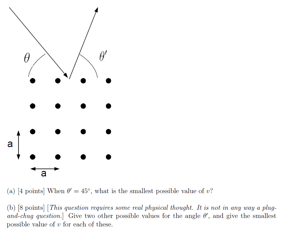

A beam of electrons of mass m and speed v is incident on the surface of a 2-dimensional square crystal of lattice spacing a. It makes an angle ##\theta = 45^{o}## with the surface. The Bragg diffracted beam leaves at an angle of ##\theta^{'}## with the surface, as shown.
(a) When ##\theta^{'} = 45^{o}##, what is the smallest possible value of v?
(b) [This question requires some real physical thought. It is not in any way a plug-and-chug question.] Give two other possible values for the angle ##\theta^{'}##, and give the smallest possible value of v for each of these.

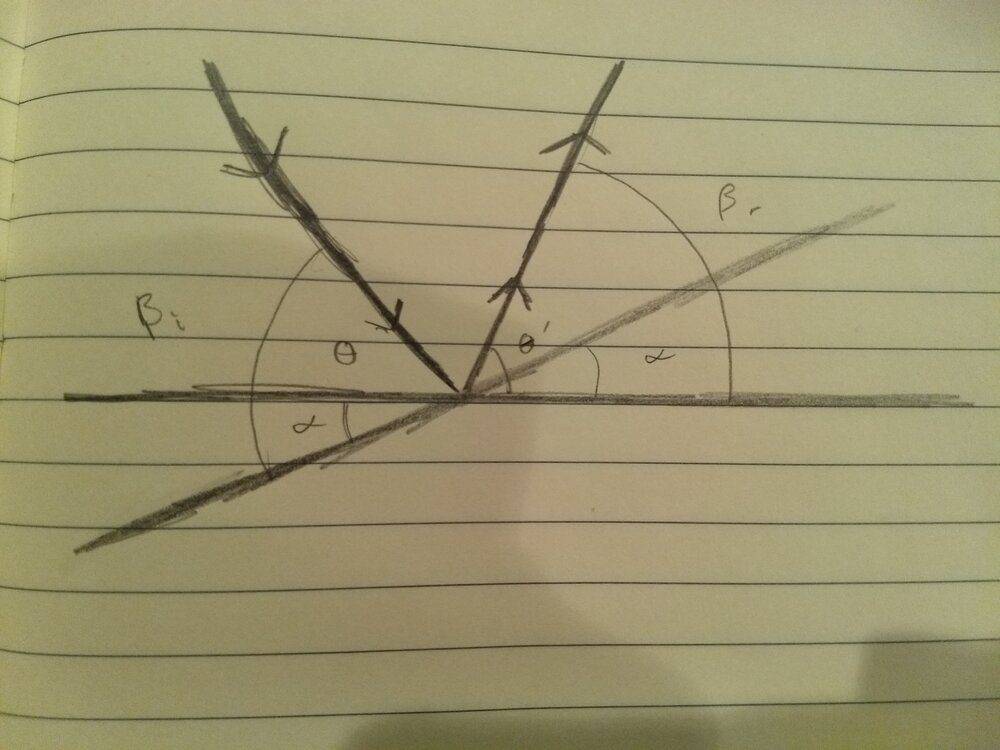

Ok so here ##\theta_{incident} \neq \theta_{reflected}##, so I suppose I need to look at a different plane. Not sure if this is the right approach, but I took an arbitrary plane at an arbitrary angle ##\alpha## from the horizontal like so:
I've shown the original beams at angles ##\theta## and ##\theta^{'}## from the horizontal, the arbitrary plane is at an angle ##\alpha## from the horizontal. ##\beta_{i}## and ##\beta_{r}## are the angles of the beams with respect to the arbitrary plane.
So for this arbitrary plane, we need ##\beta_{i} = \beta_{f}##
So ##\theta + \alpha = \theta^{'} - \alpha##
So I've got this with
##n\lambda = 2a\sin(\theta)##
##p = \frac {h} {\lambda}##
Not sure I have enough equations because I think the most I can do here is
## \frac {nh} {mv} = 2a\sin(\theta + \alpha) = 2a\sin(\theta^{'} - \alpha) ##
And I don't think I have enough equations to solve for ##\theta^{'}## or ##\alpha.## Or I took the wrong approach?

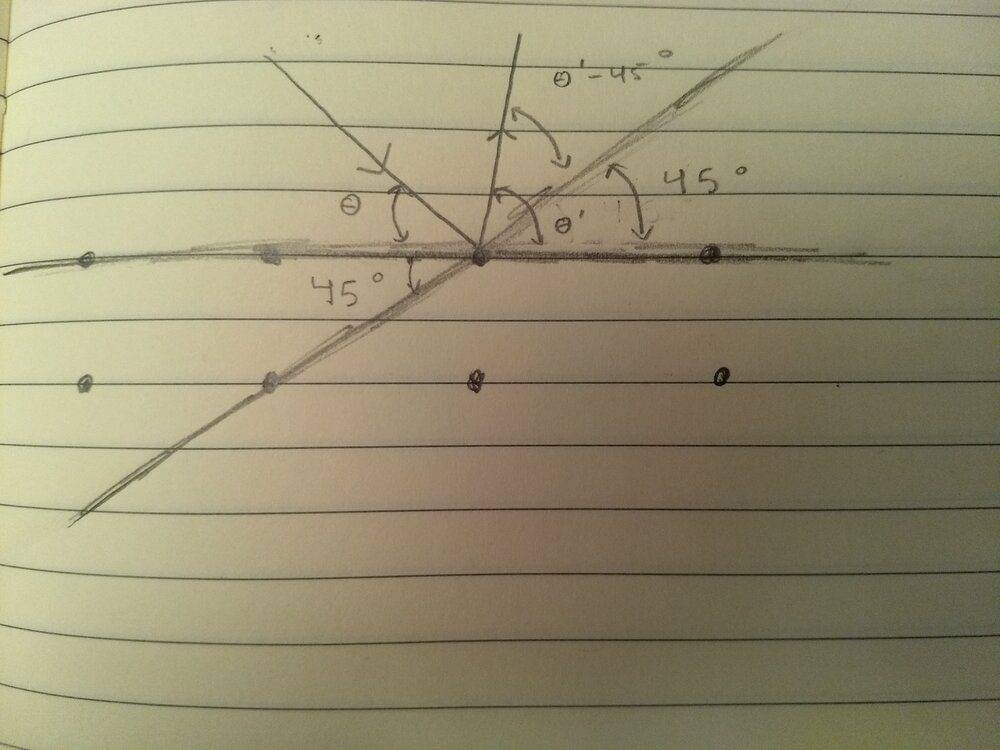

Ok, so what I'm getting it here is that I shouldn't be making ##\alpha##, the angle between this "new plane" and the horizontal plane arbitrary. I suppose -- now looking at the wording of the question again and seeing it asks for two "possible" values of ##\theta^{'}## -- I could choose any possible value for this angle ##\alpha## that relates to the lattice and solve for ##\theta^{'}##.
Not sure if I'm jumping the gun here, but here's my attempt for fixing ##\alpha## to 45 degrees and 63.435 degrees, which should correspond to a distance of ##\sqrt2## and ##\sqrt5## respectively.
Here's my interpretation of fixing it to 45 degrees:
So now using the condition
## \theta_{incident} = \theta_{reflected} ##
## \theta + 45 = \theta^{'} - 45 ##
## \theta^{'} = \theta + 90 = 130 ##
And then doing the same thing for when I fix the angle between the two planes as 63.435 degrees,
## \theta^{'} = 166.87## degrees
And I suppose finding the smallest possible value of each would just use the formula I got in part a (if that looks okay)
So for fixed angle = 45 deg and ## \theta^{'}## = 130 degrees
## v = \frac {h} {2am\sin(130)}##
So for fixed angle = 63.435 deg and ## \theta^{'}## = 166.87 degrees
## v = \frac {h} {2am\sin(166.87)}##
Is this right?
Check your arithmetic.

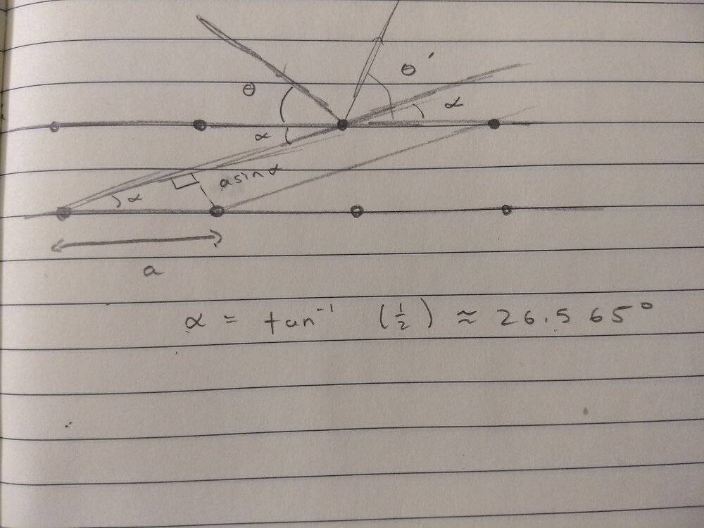

Here's my attempt for some shallower angles:
The first angle I took is 26.565 degrees below the horizontal (two nodes left and one down)
## \theta ## + 26.565 = ##\theta^{'}## - 26.565
##\theta^{'}## = 45 + 2(26.565) = 98.13
And then the smallest v should be ## v = \frac {nh} {2a\sin(26.565)*m*\sin(98.13 - 26.565)} ##
The next angle I took is 18.4349 degrees below the horizontal (three nodes left and one down)
## \theta ## + 18.4349 = ##\theta^{'}## - 18.4349
##\theta^{'}## = 45 + 2(18.4349) = 81.8698
And then the smallest v should be ## v = \frac {nh} {2a\sin(18.4349)*m*\sin(81.8698 - 18.4349)} ##

In this formula: $$v = \frac {nh} {2a\sin(26.565)*m*\sin(98.13 - 26.565)}$$
the first sine is ##\sin(\alpha)##, the second is, as you stated, ##sin(\theta + \alpha)## or equivalently ##\sin(\theta^{'} - \alpha)##.

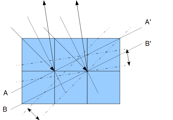

I need a better diagram to get my head around this.
I have two beams reflecting off 'planes" AA' and BB'.
The two other fine dashed lines are normals to these.
The dash-dot lines are normal to the beams and reflections.
The extra path length of the right hand beam is the sum of the lengths of the two double-ended arrows, yes?

Before I check that, let me confirm to make sure I understand this correctly: are the fine dashed lines the ones bounded by the double arrows and are the dash-dot lines the ones that make up planes AA' and BB'? Or is it the other way around?
Two fine dashed lines are the two planes of reflection, AA' and BB', and the other two are normals to these at the points of reflection.
The four dash-dot lines are normals to the incoming beams and their reflections.
The solid double ended arrows are distances between parallel pairs of dash-dot lines.

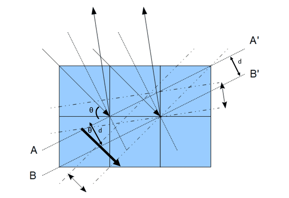

I've defined the interplanar distance between AA' and BB' as d. I've also defined the angle between the incident beam and AA' as ##\theta##. I've translated the second beam over to make things easier to visualize. That translated beam forms and angle ##\theta## with the interplanar distance d. The path difference will be ##d\sin(\theta)## plus another ##d\sin(\theta)## to account for the extra distance the beam has to travel enter and exit an extra plane deeper. So the total path difference would be ##2d\sin(\theta)##, or as you stated, the sum of those two-double ended arrows.
Hopefully this helps in the visualization.

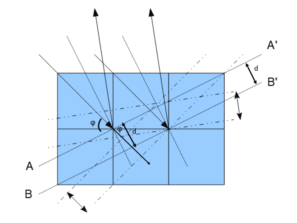

I wish you had not redefined θ.
Your diagram marks two angles as θ, one being the complement of the other?
I'll define φ as the angle the incident beams make to the tilted plane, so in terms of the original variables that's θ+α.
Also, it seems to me you have the relationship backwards. Aren't the extra distances d/sin(φ)?

Let me change it to ##\varphi##:
Ok what I head earlier seemed to have confused myself too, so let's forget about that version.
I translated the second beam so its a continuation of the first one, hopefully that's easier to visualize. ##\varphi## is the angle between the plane and the continuation of the beam, so the extra path difference is, as you said ##\frac {d} {\sin(\varphi)}##

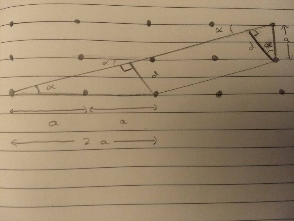

Ok. So what is the relationship between d and a?
Ok now I'm confused again.
I drew the lattice of the original problem:
I have the two parallel planes at angle alpha from the horizontal. The planes are those that go two nodes across and one down. The interplanar distance between the original horizontal planes is a, and that between the new planes is d.
I get two right triangles. The one one the top right suggests d = ##a\cos(\alpha)##. The one on the bottom left suggests d = ##2a\sin(\alpha)##.
Is that necessarily a contradiction?
Oh wait. If I plug in the numbers for that angle those are the same thing. Haha.
