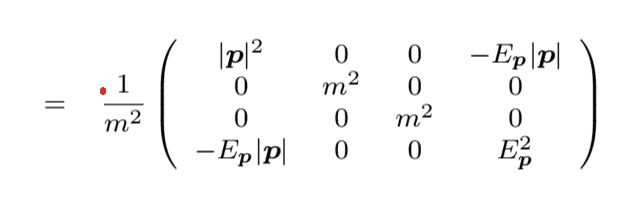

I tried multiplying the matrices together but I never get the stated answer which should be:
Equation: equals 1/m^2 times a 4 by 4 matrix with entries |p|^2, 0, 0, -E_p|p| in the top row; 0, m^2, 0, 0 in the second; 0, 0, m^2, 0 in the third; and -E_p|p|, 0, 0, E_p^2 in the bottom row.
I get the stated answer except the minus signs. Just using the result of the previous example:

So I think you got your result by using the previous example values for ε as you have said. Then, I assume you carried out the product sum with with λ =1,3. Thanks for this answer, it gets me closer but then there is still the annoying minus signs, which makes me think there must be another subtlety and that worries me.
I think they are a typo.

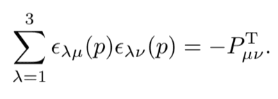

That would be great, but I am not certain since in the book that I refer to, it also gives the product involving εε in terms of a projection operator:
Equation: sum from λ = 1 to 3 of ε_λμ(p) ε_λν(p) equals minus P^T subscript μν, with a period at the end.
and that
Equation: negative P super T, with subscript mu nu, equals negative g subscript mu nu plus p subscript mu times p subscript nu divided by m squared.
When I use this method it gives the matrix including the minus signs. So I am still not confident. Anyhow, thanks for your effort, it is really appreciated.

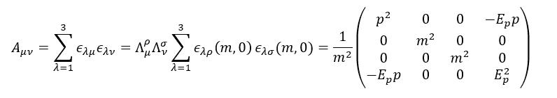

The problem is given in terms of a boost in the z-direction:
Four-momentum of a photon written as p^mu = (E_p, 0, 0, p), with components E_p, 0, 0 and p.
From this we get:
Equation: A_μν = sum over λ=1 to 3 of ε_λμ ε_λν = Λ^ρ_μ Λ^σ_ν sum over λ=1 to 3 of ε_λρ(m,0) ε_λσ(m,0) = (1/m²) times a 4x4 matrix with rows (p², 0, 0, −E_p p), (0, m², 0, 0), (0, 0, m², 0), (−E_p p, 0, 0, E_p²).
Which can be calculated independently using:
Equation A_μν = −g_μν + p_μ p_ν / m^2, where g_μν is the metric tensor and p_μ, p_ν are momentum components, divided by mass squared m^2.
Using this second method the minus signs in the A matrix arise since in the projection formula the momentum vectors are covariant and so should be:
Four-momentum vector written as p_mu = (E_p, 0, 0, -p), with components E_p, 0, 0 and -p, shown with a lowered index mu.
So for example:
Equation: A03 = -g03 + (p0 p3)/m^2 = 0 + Ep(-p) = -Ep p
Similarly for A30.

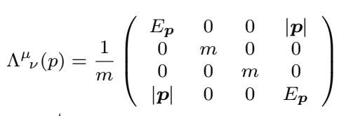

In the original problem equation 13.29 gives the boost matrix as (multiplied by 1/m):
Matrix Λ with upper index mu and lower index nu: 4x4 array with E_p, 0, 0, p in the first row; 0, m, 0, 0; 0, 0, m, 0; p, 0, 0, E_p in the last row.
However, I think there is a typo here as it should be:
Matrix Lambda with upper index mu and lower index nu equals a 4 by 4 matrix: top row E_p, 0, 0, -p; second row 0, m, 0, 0; third row 0, 0, m, 0; bottom row -p, 0, 0, E_p.
When this boost matrix is used and followed through the rest of the derivation everything is resolved - phew!
Once again thanks for your help with this it has helped me a lot as it got me to think about my calculations and, naively, I never considered typos.

Thank you for clearing this point. I think now that there is no typo at all, and the resolution for the minus sign in the original problem is the same: the polarization vectors in 13.30 are contravariant, but they are covariant in 13.40. This gives us the minus signs in the answer, doesn't it?

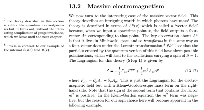

billtodd said:
A photon doesnt have a mass. it's massless.
Yes. However,
Printed page from a textbook, section 13.2 Massive electromagnetism, with footnotes on the left and the Lagrangian for a massive vector field, equation (13.17), in the text.
(Lancaster, Blundell, Quantum Field Theory for the Gifted Amateur)
I remember this Lagrangian called proca lagrangian density. otherwise I cannot recall.
