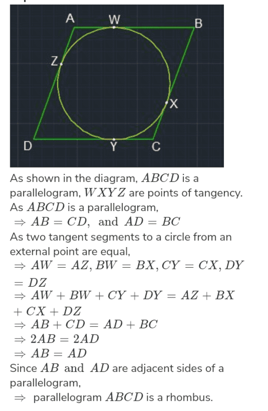

There is no additional information given. The only additional thing is the diagram. That's all that's given in the question bank.
My solution that it's a rhombus definitely makes a lot of sense.
Here's the proof that I came up with.

Your solution looks fine to me, but the wording above suggests that the parallelogram will be undergoing some change, and that's what threw me and several others off.
A better wording for the problem might be:
"If a circle can be inscribed in a parallelogram, what conditions does this fact impose on the parallelogram?"
