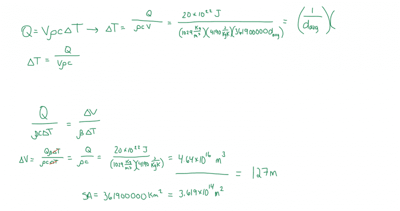

Since the 1980's a total of 20 x 10^22 J of additional energy has been absorbed by the worlds oceans. This is 90% of the additional heat our planet is storing as a consequence of global warming. The surface area of the worlds oceans is 361,900,000 km^2 and we will assume this area has not significantly changed as a consequence of global warming. What is the increase in sea level rise as a consequence of this heat? Take the coefficient of thermal expansion for water to be 0.000120 oC^-1, the specific heat capacity of water to be 4190 J kg^-1 K^-1, and the density of sea water to be 1029 kg/m3.
Q=VρcΔT
ΔV=VβΔT
ΔT=Q/(Vρc)
My guess is that since the area doesn't change, the percentage change of volume equals the percentage change of height. However, I really don't know where to go considering that the problem only gives area. You cannot use m=dv to solve, because mass and volume are both unknown. Since area is constant, if I simply plug that into the equation, I get ΔT = (20*10^22 J)/((361900000km^2)(1029 kg/m^3)(4190 Jkg^-1K^-1)) = 128177564º, which is clearly incorrect and unreasonable. Even if you go from here assuming this is just a question for concepts where numbers don't matter, ΔV=VβΔT=(361900000km^2)(.00012ºC^-1)(128177564º)= a huge number that is incredibly unreasonable. What am I missing here?

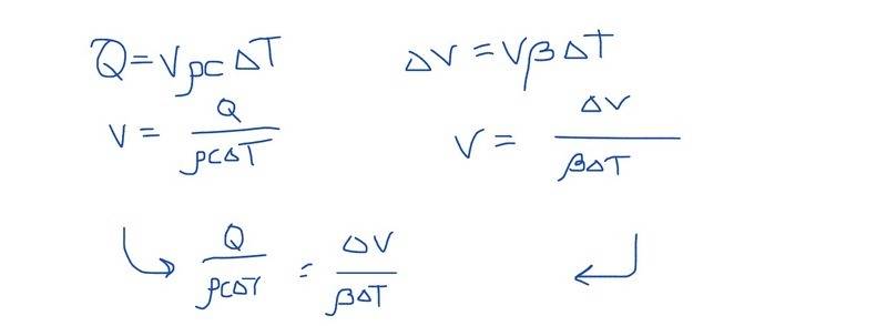

You know the equations
ΔV=VβΔT
ΔT=Q/(Vρc)
What happens if you substitute the second equation into the first and simplify (before substituting any numbers)?

Right, I substituted area for volume because volume isn't given and wasn't sure if that would work out or not, because area is constant. Thanks for pointing out units however, I do need to change to m in order to match the density. If I do as you suggested and combine the equations, I am still left with two unknown variables.
Do you see anything that will cancel out in the last equation above?

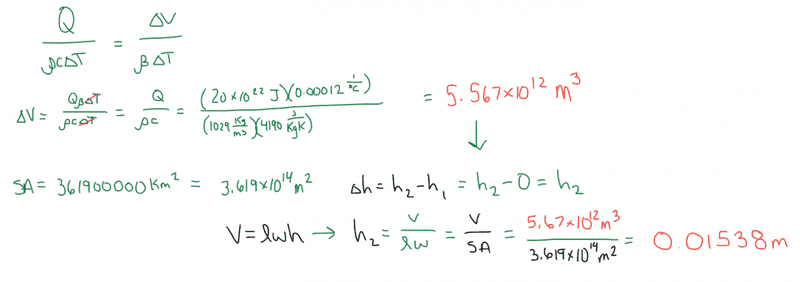

Ah, yes, the ΔT goes away. Am I able to divide the ΔV by the surface area to get my units to m for height as I did below?
dakota224 said:
Ah, yes, the ΔT goes away. Am I able to divide the ΔV by the surface area to get my units to m for height as I did below?View attachment 95606
Ignore the top part of that, just scribble...
Did you drop the factor of β in the calculation?
Otherwise, I think you basically have it. Make sure you understand why the change in depth equals the change in volume divided by the area.

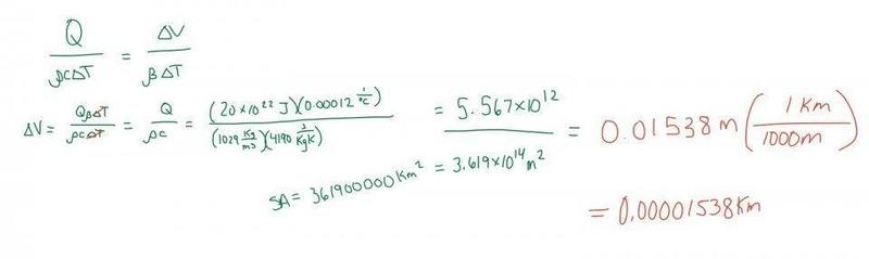

Yes I did, here's the updated work:
I submitted this answer (online submission) and it was correct! Thanks so much for your help!
OK. Note that kilometers is probably not the best choice of units for expressing this particular change in height.
Also, you should try to make your equations logically correct. As you can see, you started with ΔV on the left and after a series of equal signs, you ended up with a height (and you know a change in volume cannot equal a height). That's likely to confuse the reader (who might also be your grader!).

Here is updated work with a logical equation. I solve for change in volume (m3). Then, I can use the formula height = Volume(m3) / area (m2) to get my final answer, by plugging in the volume value and the surface area given in the problem.
OK. Good work. In the second line, the third expression is missing the β. But that's just a "misprint".
There is no need to take h1 = 0. Think of the volume as V = Ah where h is the average depth and A is the surface area which is assumed constant.
Then ΔV = V2 - V1 = Ah2 - Ah1 = A(h2-h1) = AΔh.
So, Δh = ΔV/A. Thus, you can calculate Δh directly from ΔV and A without worrying about individual values of h2 or h1.
