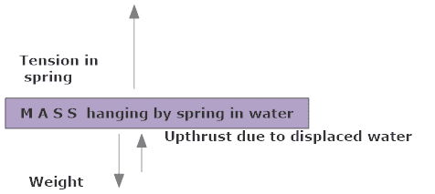

A spring (k = 500 N/m) supports a 400 g mass which is immersed in 900 g of water. The specific heat of the mass is 450 J/kg and of water is 4184 J/kg. The spring is now stretched 15 cm and, after thermal equilibrium is reached, the mass is released so it vibrates up and down. By how much has the temperature of the water changed when the vibration has stopped?
I am ending up with ΔT ( change in temperature of thermodynamic system) and ΔUint (change in internal energy of thermodynamic system) as unknowns and one equation only, so it seems it's not possible to solve for temperature change ΔT.
heat = mass x specific heat X temperature change
[/B]
Let's consider the spring + water as a closed system. Also, let's look at the system starting from when the spring is in water and mass hanging from it in an equilibrium position to when mass returns to it's original position and vibration of spring has stopped. Then, for this system the following points will be true.
  • there could be some heat flow across the system's boundary $$\Delta Q_{in} \neq 0$$
  • the system does not do any work on it's surrounds nor is work done on the system $$W_{by} = 0$$
  • the internal energy of the system should increase as it's temperature will rise $$\Delta U_{int} > 0$$
  • the change in KE of the system is zero since it has no translational motion $$\Delta KE = 0 $$
  • the change in PE of the system is change in spring PE + change in gravitational PE ( change in gravitational PE is zero but change in spring PE is not zero since the spring is less stretched at end of interval being considered i.e. spring PE has decreased)
So, the first law of Thermodynamics becomes
$$(0 - 0) + (0 - \frac{1}{2} \times k \times x^{2}) + \Delta U_{int} = Q_{in} - 0$$
$$(0 - 0) + (0 - \frac{1}{2} \times 500 \times 0.15^{2}) + \Delta U_{int} = Q_{in} - 0$$
Also, by using the second formula under Relevant Equations using specific heat we get another equation. If ΔT = temperature change in K over the time interval being considered, then
$$Q_{in} = 0.9 \times 4184 \times \Delta T + 0.4 \times 450 \Delta T$$
If we combine above two equations then we get the following equation.
$$(0 - 0) + (0 - \frac{1}{2} \times 500 \times 0.15^{2}) + \Delta U_{int} = 0.9 \times 4184 \times \Delta T + 0.4 \times 450 \Delta T - 0$$.
It's impossible to solve for ΔT since we have two unknowns in above equation. I am not sure if I am applying first law of Thermodynamics correctly.
NOTE: However, if Qin is assumed to be zero since heat flows are happening within the system due to fluid resistance against vibration, and ΔUint = 0.9 x 4184 x ΔT + 0.4 x 450 ΔT then by substituting into first law of thermodynamics equation, we get only one unknown of ΔT which we can solve. But, I am not sure if this second approach is correct.

I am thinking that the initial equilibrium position of mass should be same as final equilibrium position of mass according to free body diagram below, which will mean initial and final gravitation PE are equal.
When mass is in initial rest position ( not when its stretched by 15 cm but before that when it's hanging by itself from spring in water) or when it has finally stopped after vibration in water, then the following equation is satisfied.
Tension in spring = weight + upthrust due to displaced water
kx = weight + upthrust due to displaced water
Since k ( spring constant), weight of mass and upthrust due to displaced water are going to be same in both these positions, so x (amount by which spring is stretched) is going to be same in both positions. Therefore, we can say that gravitation PE are same in both these positions.
Also, then equation from first law of Thermodynamics should be different as below.
$$\Delta KE = 0 \text {, } \Delta PE = 0 \text { for both gravitational and spring PE, } Q_{int} = 0 \\ \text {but } W_{by} = -\frac{1}{2}kx^{2} \text { since spring was initially stretched by 15 cm and so work was done on the system}$$The first law of Thermodynamics would then become as below.
$$(0) + (0) + \Delta U_{int} = 0 - (-\frac{1}{2}kx^{2})$$
We can substitute ΔUint = 0.9×4184×ΔT+0.4×450ΔT in above equation.
If you are going to take as the initial state the equilibrium rest location of the mass, then you need to include the work done in lowering the mass as part of the process, and this will also involve gravitational (buoyancy) effects. If you take as the initial state, the lower mass location with the stretched spring, then there is some mass of water that is at a higher elevation than at equilibrium and the mass itself which is at a lower elevation than at equilibrium.
Yes, I realized that after posting my last message and have modified the post accordingly. Thanks for your great help. I think the upthrust is being ignored in this problem else the volume of the mass would be mentioned..

Fourth, after the spring is released, the elastic potential energy is divided unequally between the water and the mass. A simple equation involving the given specific heats describes this mathematically and can easily be solved to find ##\Delta T## because it is the same for both water and 400-g mass.
Additional assumption: The simple harmonic motion is underdamped and the mass eventually ends up at its equilibrium position.
N.B. In post #15 OP suggests that this problem involves conservation of (total) energy and that using the first law of thermodynamics is "overkill." OP might wish to consider that conservation of total energy, conservation of mechanical energy, the work-energy theorem and the first law of thermodynamics are all manifestations of the same idea: "The net change is what goes in less what comes out; if nothing goes in or comes out, the net change is zero." It works with bank accounts too.
erobz said:
In the first law Q−W=ΔE the heat can go to a number of energy sinks on the RHS in the system. Q=mcpΔT is a very special case of the first law.
I see. What will be W according to the situation you have explained?
If W = 0 then I can understand why in this problem, ##\Delta U_{int} = mc\Delta T##. But, why would W = 0 beats me.
I'm not sure, but my gut instinct is I think you have to be careful about selecting the system boundary.
If you make a boundary only around the water (excluding the mass) we can write the first law for it. It absorbs some heat, gains some bulk kinetic energy, and it does work (through friction force ##f_r##) on the mass\sping to bring it to rest. Then you can isolate the mass\spring and write the first law from its perspective. It too absorbs some heat, and does work on the water through friction force ##f_r##. A friction force is doing work on both of them that in that in the end ( after thermal equilibrium is once again reached between the water and mass\spring) is converted to waste heat. I think in the end all three of these things combine to give you:
$$ \int f_r ~ds = \frac{1}{2}k x^2 = Q_{{abs}_w} + Q_{{abs}_b} = \left( m_w c_{p_w} + m_b c_{p_b} \right) \Delta T $$
Thats the best idea I can come up with.
