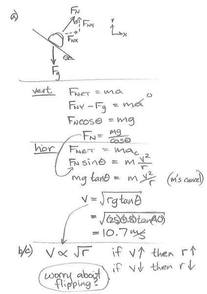

Example #4:
A bobsled goes into a turn (r=25m) with an banked angle of 40 degrees. Assuming no friction (pretty good assumption), a) what is the velocity of the bobslead b) what happens if the bobsled comes into the same turn above this speed? c) what happens if the bobsled comes into the same turn below this speed?
Handwritten physics derivation for a bobsled on a banked turn: free-body diagram with FN, FNy, FNx, Fg and angle θ, then vertical and horizontal force equations leading to v = sqrt(rg tanθ) = 10.7 m/s, plus a note on v proportional to sqrt(r).

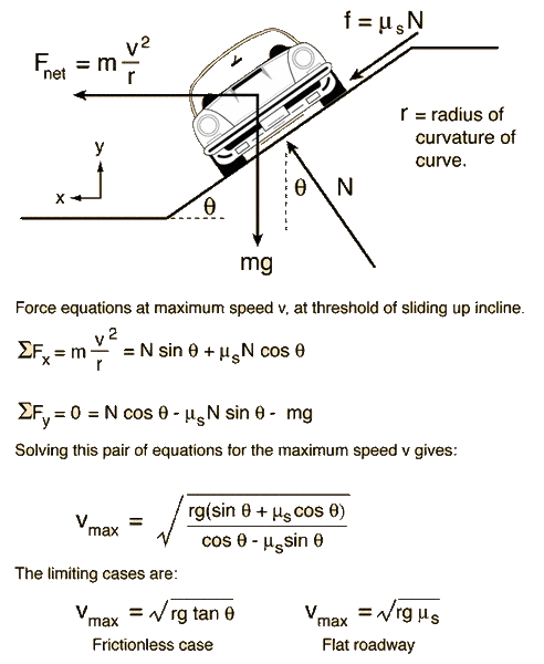

I have found through another diagram
Free-body diagram of a car on a banked curve with the x and y axes shown, forces labeled Fnet = m v^2/r, f = mu_s N, N and mg, and the angle theta marked at the incline, with force equations and the derived maximum speed v_max formula below.
however i am unfamiliar with how to get
that vmax from the x and y and would love some help there deriving it.
either way though using that vmax for frictionless i get 14.3ms. I think the answer she gets is just not using the right order of operations
It's not clear to me which is your solution and which your teacher's. The handwritten one is fine except for the numerical calculation at the end. It should produce 14.33, or thereabouts.
the hand written is hers, and yeah i thought so as well. very annoying taking a course with so many errors
