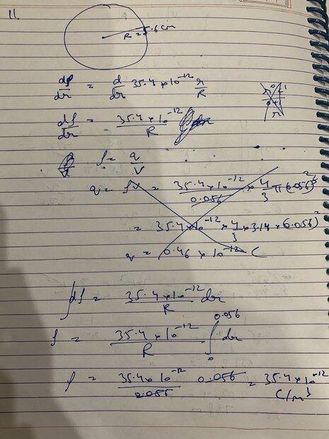

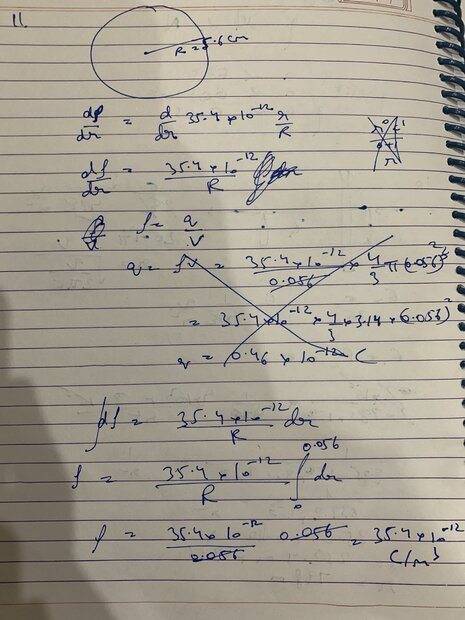

The volume charge density of a solid non conducting sphere of radius R= 0.056 m varies with radial distance r as given by rho=35.4r/R pC/m^3.
What is the sphere total charge?
What is the field magnitude E at r=0, r=R/3, r=R ?
V= 4/3 pir^3
E=1/4pie0q/r^2

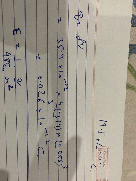

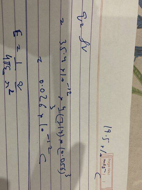

First I did drho/dr which is equal to 35.4*10^-12/R. Then I integrated drho by which I got rho=35.4*10^-12. And then the last eqn will be q=rhoV. But the answer was wrong.
I have a doubt on the formula I am using for E because that formula is for a point charge or a charged shell.
Why did you differentiate it then integrate again?
q is not rho*V because rho is not constant over the volume. You have to integrate ∫rho*dV
Homework Statement: ...
Relevant Equations: V= 4/3 pir^3 ... E=1/4pie0q/r^2 ..
... I have a doubt on the formula I am using for E because that formula is for a point charge or a charged shell.
... E=1/4pie0q/r^2##~\Rightarrow~E = \frac {1} {4πε_0} \frac {q} {r^2}~\Leftarrow~\begin{cases}\begin{align} & \text {for a point charge}~q~, \text {a mathematical} \nonumber \\ &\text {point without any size nor shape,} \nonumber \\& \text {without any extension in space}~\dots\nonumber \end{align}\end{cases}##
For an extended 3D body (a point large enough to have size and shape in 3D but still small enough to be treated as a point in comparison to other neighboring bodies, the concept of a volume element ##~dV## is used. The total volume ##V## is then the sum of all the volume elements ##~dV_i~## comprising the body: ##~V=\sum_{i}## ##dV_i##. If the volume elements are sufficiently small, then they can be treated as point partcles and the total 3D region containing them, including the empty spaces between them, can be said to be occupied by a discrete set of particles.
But if the sufficiently small volume elements are so close together that there are no empty spaces left between them, then the sum is replaced by an integral: ##~V=\int_\rm R## ##dV##. The total region R enclosing all the volume elements is then said to be occupied by a continuous distribution of elements.
In the case of a charge ##q~##sufficiently small to be treated as a point charge, we have the ordinary product ##q = ρV##, where ##ρ## is the charge density. But if ##q~##is not small enough and its size and shape must be properly taken into account, then ##q~##must be divided into sufficiently, smal enough charge elements ##~dq~##, each one occupying the volume element ##dV##, whose integral ##\int_\rm R## ##dq = q = \int_\rm R## ##ρdV~##gives the total charge ##q##. If the charge density is not constant but varies inside the region R, then ##ρ## cannot be taken out of the integral sign.
The preceding is true only for scalar quantities like the total charge. For a vector, like the electric field vector, the integral ##\int d\vec E = \vec E## is more difficult to evaluate directly. Instead, the magnitude and direction are treated separately.
... ##dq~\Rightarrow~##production of field ##d\vec E~##with scalar magnitude ##dE =\frac {1}{4πε_0} \frac {dq}{r^2} = \frac {1} {4πε_0} \frac {ρdV} {r^2}##...
Using the convention that ##\vec E## vectors at the field point move away from positive charges while they move toward negative charges, addition or cancellation of scalar components of vector can be achieved by using symmetry considerations.
O yes!
Why dV? Are we taking a shell of volume dV with charge dq in it and it’s density as rho. Then we put the value of rho given and 4pir^2dr in place of dV. So the integral is in terms of r. Integration from 0 to .056 m.

Since ##ρ## is the volume charge density, you have to multiply it by the volume element ##dV##.
O yes!
It is a shorthand. If you are integrating over a volume, you add up the contributions of a bunch of infinitesimal volume elements. If you are integrating over an area, you add up the contributions of a bunch of infinitesimal area elements. If you are integrating over a line, you add up the contributions of a bunch of infinitesimal line elements.

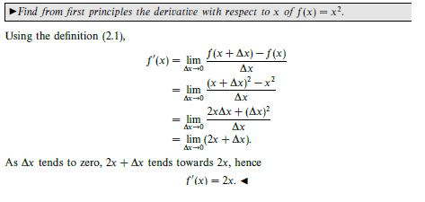

I thought you want to solve a problem in physics involving total charge and the electric field? Now, all what we're talking about is differential calculus. Anyway, it doesn't really matter. If you need help in mathematics, that's okay.
To understand the derivative of a function like the one that you gave, ##f(x) = x^2##, we cannot confine ourselves to that only. We have to look more closely to the given function because different functions give different rates of change ##\Delta f/\Delta x##.
Now, to know the change ##\Delta f## of a function ##f(x)## , one must first have a change ##\Delta x## in the independent variable ##x## . But without a particular value for ##x##, say ##x = x_0## , one cannot talk about its change. But before changing ##x_0## one must first substitute ##x = x_0## in ##f(x)## because one would like to know later how ##f_0 = f(x_0)## changes when another value of ##x## is used. After that, one changes the value of ##x_0## by a certain amount, say ##\Delta x## , so that one now has a new value for ##x## , namely ##x_1 = x_0 + \Delta x##. Then, ##x_1## is substituted in ##f(x)## to get its new value ##f_1 = f(x_1)## . Afterwards, examine changes in ##\Delta f = f_1 - f_0## caused by changes in ##(x_1 - x_0)## brought about by slowly reducing the value of
##\Delta x## in ##x_1## while keeping the value of ##x_0## fixed.Try it for ##f(x) = x^2## with ##x_0 = 2## , ##\Delta x = 0.1## and then reducing ##\Delta x## to the values ##\Delta x## = 0.01 , 0.001 , 0.0001 . Have fun while learning.

It’s coming as 4.1, 4.001, 4.0001 and so on.
Do you understand now what I meant by saying that ##\Delta f/\Delta x## slowly approaches a fixed value and eventually stop changing ?
But I don’t think it will ever stop at a fixed value.It will come as 4.000000000000000000000000000000000000….and then some digit….
Of course it will since ##4.0 = 4.0 × 10^{-10} = 4.0 × 10^{-100} = 4.0 × 10^{-1000} ~\dots~\rm {etc}## . But if you want the negative exponent of ##10^{~n}## to stop, nobody can ever do it. Exactly the value of 4.0 means ##4.0 × 10^{-\infty}##. If you count from 1 to ##\infty##, you will never stop counting.
