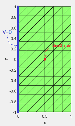

I have a code that solve the poisson equation for FEM in temperature problems.
I tested the code for temperature problems and it works!
Now i have to solve an Electrostatic problem.
There is the mesh of my problem (img 01).
At the left side of the mesh we have V=0 (potencial).
There is a line charge located in (0.5,0) with charge density λ=1/(4*pi).
The poisson equation for electrostatics is:
My dificulty is how to solve it for a line charge (what is the best equation for ρ). I used the Dirac delta, and some aproximations for delta function but my code has wrong results.
Hi,
then how did you specify a pointlike heat source ?

BvU said:
Hi,
This is the Poisson equation for temperature problem.
Note that temperature is in left side of equation.

Alan,
I've done a lot of electrostatic calculations, analytical, numerical and FEA. However, I don't quite understand your question.
Could you elaborate on it? Draw a picture without a mesh to start with.
Are you trying to calculate the field of a charged wire next to a ground plane?
