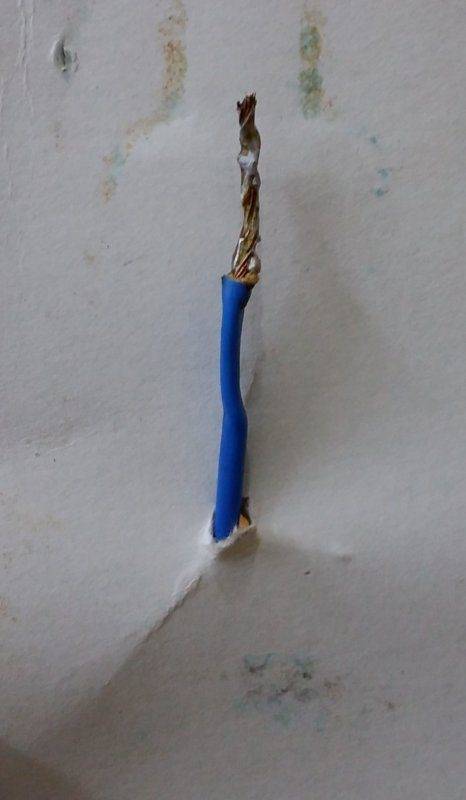

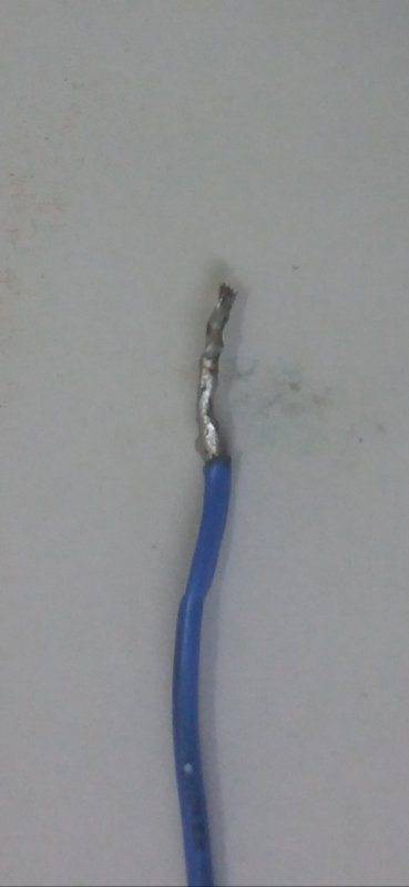

I have a 25W soldering iron. I am trying to learn this art from Youtube. From the videos, it seems that soldering is not much difficult. But in practice, it just doesn't work out for me.
For example, consider this video among a few thousands on this topic. You can see how easily the solder sticks to the twisted wires once the iron is touched. But in my case, the solder just doesn't stick! Sometimes, even the other end of the wire gets hot, but the solder won't stick. I have tried with wires of different thicknesses (from single wires to thick ones meant for carrying 18A, all copper), using solder wires with and without lead from different companies, and even used the flux paste (which is advertised to give a smooth and uniform solder), but with no success.
Solder, however, melts if I directly touch it to the soldering bit. But not on any wire.
I have tried cleaning the bit on a sponge, and then on steel wires to remove any residual solder. But with no effect.
Should I buy a higher power soldering iron? Something like https://www.amazon.com/dp/B07HM1DMLN/?tag=pfamazon01-20 or maybe https://www.amazon.com/dp/B07HM34RFZ/?tag=pfamazon01-20? Or is it something else that I am missing?

25W should be adequate for finer wires, say 22AWG (0.6mm). When a problem occurs, either the wire is not hot enough or it is oxidized (tarnished).
An oxidized tip prevents heat transfer to the wire.
If solder melts when applied to the wire but does not stick, then the wire is oxidized and needs cleaning. This can also occur if flux is not used. The flux dissolves the oxidation and allows contact between the wire and solder.
  • The wire should be shiny, not tarnished.
  • Wipe the tip on a damp sponge to remove oxidation that occurs when exposed to the air.
  • Apply a SMALL amount of molten solder on it.
    • The tip should have a thin coating of shiny solder on it, if not, apply some flux and solder. This is called 'tinning' the tip. Repeat the two steps above and this one until the tip is shiny.
    • Again wipe the tip on a damp sponge and apply a SMALL amount of molten solder on it.
  • There must be some flux on the wire, or at least on the solder on the iron tip.
  • Apply the tip to the wire where the small amount of solder is. Be sure the tip is contacting the wire to get the wire hot.
  • Often some slight scrubbing motion of the tip on the wire is needed to get thru any oxidation on the wire.
  • When the wire shows signs of accepting the solder, apply more solder as needed to the wire next to where it contacts the tip. Do NOT apply the additional solder directly to the tip and expect it to transfer to the wire, it won't.
Remove the tip from the joint but do not move or disturb the joint until the solder solidifies. This is needed because as the solder cools, it cools to slightly below its melting temperature before actually solidifying. If it is disturbed at this super-cooled stage it will flash-freeze to a granular consistency that is mechanically very weak. Upon solidifying the solder should have a smooth, shiny surface.
Hope this helps.

Does the tip have a shiny coat of solder, or is the tip grey or black? If it is grey or black that is oxidation and there will be little heat transfer to the wire.
Cheers,
Tom
EDIT:

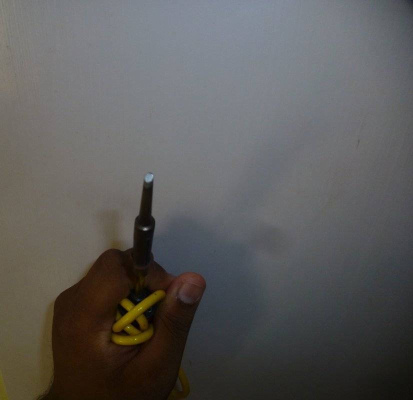

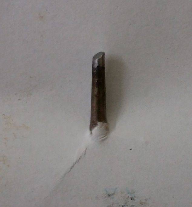

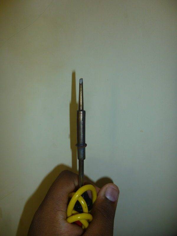

Can you post a photo of the tip?
I won't boast that these are good pictures, but should help you identify whether the tip is shiny or not.
OK, the first photo shows a shiny tip. The second photo looks like not shiny.

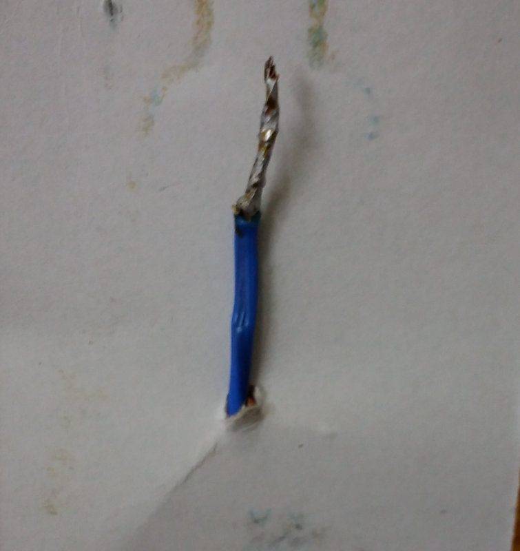

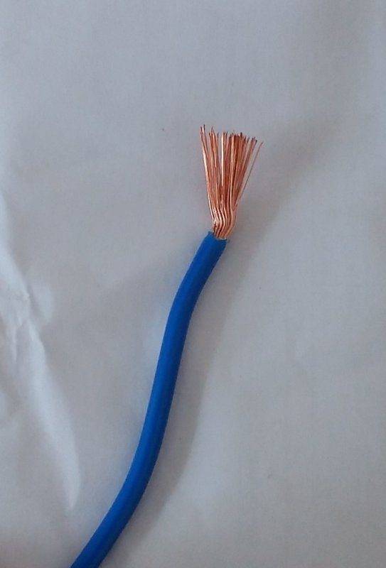

OK something obvious that no one else has mentioned
Are you absolutely sure that it is bare copper wire ?
That is, I am wondering if it is enamelled wire, which would be hell to try
solder to ? There are some enamels that will burn off with the heat of a
soldering iron others that wont
The soldering iron you linked to should be idea for most home electronics
it has a good temperature range and the 350 - 400C would be where you would use it most
other than for small delicate components
IF you are using proper rosin flux cored solder, you DONT need any other flux
In 50 years of doing soldering at home and at various job, I have never had the need
to use additional flux the cored flux has never failed me
your iron tips look OK
would like to see a photo of the wire ends you were trying to soldercheers
Dave
