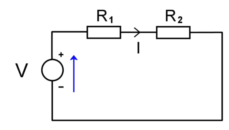

mudmucker said:
Just as an example if I take this generator 350W at 24V gives us about 14.6A (P=I*V). That means the internal resistance of the motor is 1.6 Ohms (V=I*R). What I've always used for calculating power loss in a wire is P=V*I^2; which gives us 350W.
Your calculations assume the whole 24V is applied across the internal resistance. That is true only if the generator is short circuited. Instead, think of the circuit below. R1 is the internal resistance and R2 is the load resistance. Think of a light bulb for example. Now if R2 is much greater than R1, then most of the voltage drop and power consumption will be across R2, not R1.
Ideally, the internal resistance R1 would be zero and the efficiency of the generator would be 100%. But in the non-ideal case, we can make R1 as small as possible.
