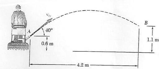

Knowing that snow is discharged at an angle of 40 degrees, determine the initial speed, v0 of the snow at A. Answer: 6.98 m/s
Diagram of a projectile: a worker at point A on the left launches snow at 40 degrees above horizontal with initial velocity v0; the dashed parabolic path reaches point B, with 0.6 m vertical height at A, 1.1 m at B, and 4.2 m horizontal distance between them.
Handwritten projectile motion working: given angle 40 degrees, x0 = 0, xf = 4.2 m, y0 = 0, yf = 0.5 m, ay = -9.8 m/s^2, ax = 0; kinematic equations split into x and y directions, ending with a quadratic solution for time t.
I have found the x and y velocity and position formulas. Now since I don't know time, should I solve both position equations for time (t) and set them equal to each other to get my only unknown, vi? The quadratic equation for time in the y-dir seems a bit hectic. Is there an easier way to go about trying to find vi?
Start with
L = v0 t cosθ
Δy = v0 t sinθ - (1/2) g t2
Solve the first equation for t and replace in second equation. Solve the ensuing equation for v0.

I believe this is what you had in mind. The answer matches the professor's answer. Thanks again kuruman!
Handwritten derivation eliminating time from projectile equations: t = x_f/(V_i cos θ) substituted into y_f = V_i sin θ t - 4.9 t², leading to V_i² (y_f cos²θ - sin θ cos θ x_f) = -4.9 x_f², giving V_i ≈ 6.98 m/s.
