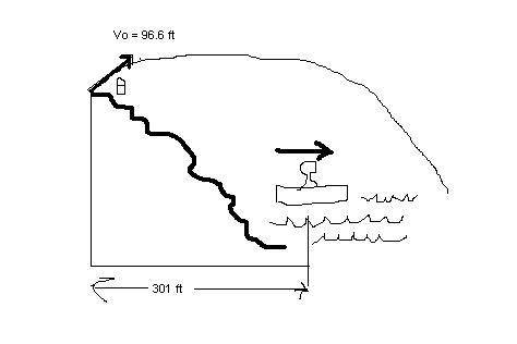

im giving a problem where i have to find the angle a projectile situated at the top of a will hit an boat wit constant velocity 20 ft/s 5 sec after starting at Vo = 96.6 ft/s and also how high the hill is above the water. The distance from the base of the hill to the boat is given to be 301 ft.
i found the distance the boat travels after 5 seconds to be 100 ft. now I am trying to calculate the Vx and Vy components of the projectile to get theta, any suggestions?? thanx

Draw a vector triangle and use cos and sine functions. youll see it.
i found the angle but how do i find the height of the hill?

Again, which are the equations of displacement? Use the height of the hill as an initial, let's say, y-position.

The projectile follows a parabolic trajectory, but it is starting at a higher elevation than it will end.
One simply finds the point at which the boat and projectile paths intersect at 5 seconds.
The boat travels 100 ft in 5 seconds, the project must travel (310 ft + 100 ft = 401 ft) in those same 5 seconds. Knowing the distance traveled and the time, what value can be calculated?
i figured that part out already but now i am having a hard time computing the height of the hill, I tried making a triangle out of the picture but i only have one side 301 and one angle 90 degrees, am i missing somrthing?
Well, if one has the equation of the parabolic trajectory, then one can determine the time from start to the peak of the trajectory, and from peak of trajectory to impact point. One can then subract the distance traveled from beginning to peak from the peak to impact and that gives the starting elevation.
So one has calculated the angle at the beginning?
Bear in mind, assuming no wind resistance, the horizontal velocity is constant.
