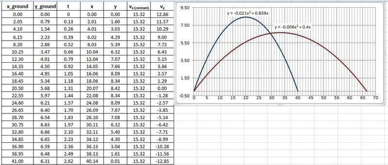

*****Excel table and graph are attached.

I plotted the data in excel and obtained the equations for both. I tried to figure this out algebraically, but my answers were way off. My values for x were 0 and 12.95. So I plugged the two equations in my Ti-89 titanium and checked the intersection with that. And it made more sense.
x = 29.47 m
y = 6.58 m
So I believe that this is my answer for part a.

The equation of motion that you have found is correct. That is very good. You can use it to solve all the parts.
The results you obtained for part a numerically are slightly off. It is not clear why you could not solve the part algebraically, perhaps you need to show your attempt.
For part b, knowing the coordinate x of the impact point, you should be able to determine the time of impact, and from that, the vertical velocity component.
For c, you answer is close. Perhaps you need to show how you got it.
For d, you need to compose the equation of the distance from the ground at any coordinate x. Then find its maximum.

Part A:
After I graphed the data and obtained my equation for the path of the projectile, I did what I remembered and set each equation equal to each other and solved for x, then substituted that into one of the equations and solved for y.
My answers were: x=0/x=21.95 & y=6.75
Now my y coordinate seems to be okay, but the x=21.95 seems off. And when I checked the excel graph, that number seemed like the vertex of the path.

aaronfue said:
Part A:
You have the correct equation of motion ## y = -0.021 x^2 + 0.839 x ##. As you say, you should equate this with ## y = -0.006 x^2 + 0.4 x ##, getting ## -0.021 x^2 + 0.839 x = -0.006 x^2 + 0.4 x ##, or, simplifying, ## (-0.015 x + 0.439) x = 0##. It is satisfied when ## x = 0 ##, which we don't care about, and when ## x = 0.439/0.015 = 29.267 ##.
How could you get x = 21.95?
Except that you should use the correct value of x, your steps are correct. You should just continue: since you know both the horizontal and vertical components of velocity, you should be able to find its magnitude and angle.
What is the distance above the ground at some coordinate x?
I made a calculation error. I get the same answer as you do now.

For part d, would I have to find the difference of the two parabolas, differentiate w/respect to x, solve for x and then plug that into solve for y?
Yes, your program is correct.
