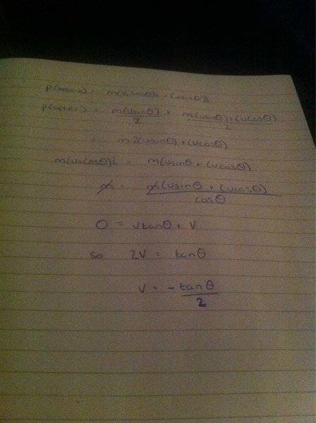

v=tanθ/2
So as a vector v= (vcosθ)i-tanθ/2 j
Although I have not considered the loss of mass for the x component in the above! I know horizontal velocity is constant with constant mass but mass here changes?
KiNGGeexD said:
v=tanθ/2
Not sure where this comes from. For one thing, the right hand side has no units! So it cannot equal a velocity.
What's the initial velocity of something that is dropped vertically?
It is zero
KiNGGeexD said:
It is zero
Right! (That's how I interpret the given information.) So what is its momentum?
And what must be the momentum of the second piece? And thus its velocity?

A ball of mass M is ejected from a mortar firework at speed v at an angle θ to the horizontal. At the top of its trajectory, it explodes into two equal pieces of mass M/2. One piece drops vertically.
What is the velocity of the other piece right after the explosion?That's the exact words

Rewrite that as:
m(vcosθ) = m(vafter)/2
Solve for vafter.
V(after)=2(vcosθ)Where the v in the RHS is initial?
KiNGGeexD said:
V(after)=2(vcosθ)
Right.
