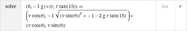

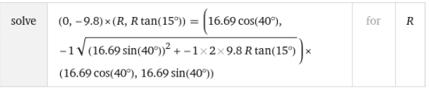

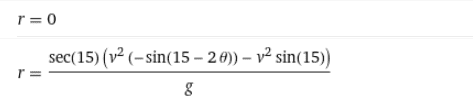

Ah yes - there's always a simpler way! Wolfram Alpha chugs through the literal equation:
to obtain:
which can be manipulated into the much simpler form shown by @PeroK above.

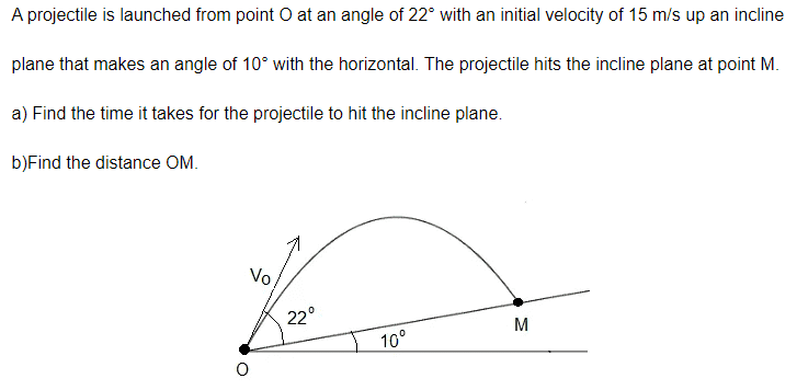

I found a solution (per @PeroK 's expression above) and then went looking for a problem! Here it is:
b) $$x = \frac{15^2\sin(64^{\circ})}{9,8}\times \left(1-\frac{\tan10^{\circ}}{\tan32^{\circ}}\right)\approx 14,81m$$ $$\implies OM=14.81 \sec10^{\circ}\approx15,04m$$ a) $$t=14,81 \div (15\cos32^{\circ}) \approx 1,16 s$$ This is Problem 2 from this set of problems.
