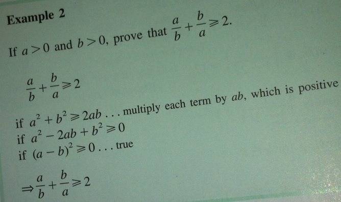

I can see what you're getting at, but I've included an image of an example question from the textbook I'm using. Is the books approach wrong, or have I followed their method incorrectly?

Regarding you textbook's example, which I think we've seen before:
It reminds me of the steps one might take on scratch paper to figure out how you might go about doing the actual proof. Starting with what you want to prove, you work backwards toward something(s) you know to be true.
So, for the case of the example:
Assuming a>0 and b>0,
[itex]\displaystyle \frac{a}{b}+\frac{b}{a}\ge2\[/itex] is true if [itex]\displaystyle a^2+b^2\ge2ab\ .[/itex]
[itex]\displaystyle a^2+b^2\ge2ab\[/itex] is true if [itex]\displaystyle a^2-2ab+b^2\ge0\ .[/itex]
[itex]\displaystyle a^2-2ab+b^2\ge0\[/itex] is equivalent to [itex]\displaystyle (a-b)^2\ge0\[/itex] which true.​
Most mathematicians would look at this proof as being written in reverse of the usual order.
IMO: The following is a more conventional order.
Assume a>0 and b>0.
[itex]\displaystyle (a-b)^2\ge0\,,\[/itex] the square of any real number is non-negative.
Expanding the left-hand side gives us: [itex]\displaystyle a^2-2ab+b^2\ge0\ .[/itex]
Adding 2ab to both sides results in: [itex]\displaystyle a^2+b^2\ge2ab\ .[/itex]
ab>0, so dividing both sides of the inequality by ab gives the desired result, namely: [itex]\displaystyle \frac{a}{b}+\frac{b}{a}\ge2\ .[/itex]​

I was on the this site, a few weeks back, with questions about Proof by Induction, and there was a lot of disagreement then about how those questions should be answered. This book is actually meant for state exams, so I don't know if a drop in the quality of solution, compared to university level math, is a consequence of that, or just a matter of preference by the author of this particular text...?

The notation in the book is not incorrect; it's just not what most of us are used to seeing.
If..then is the logical statement implies.
If A then B
is the same as
A -> B
The statement is false only if A can be found to be true while B is false. This is exactly what the problem in the book is doing, based on a chain of "if A then B, if B then C,..."
