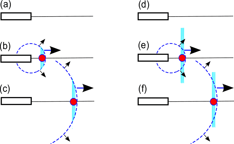

As a cartoon is worth a thousand words, I'll show you one here:
Frames (a), (b), (c) on the right hand side show how the electric field of the ejected electron bunch must be formed according to classical theories: (a) there is no field in the room before the bunch has left the accelerator pipe. The pipe is shown by the rectangle on the left; (b)+(c) as the bunch (red dot) emerges from the pipe there are two components of the field: a sphere of the transient radiation (dashed line) which expands with the speed of light and the quasistatic "pancake" electric field (light blue lines) whose transversal dimension gradually increases.
You are right that "propagation speed of a static field" is a misnomer. Perhaps a better name would be "the speed of field's formation or field buildup." Obviously, in this case this speed is equal to the speed of light.
Frames (d), (e), (f) show Pizzella observations. The pancake electric field was fully formed immediately after the bunch left the pipe. Obviously, the pancake field penetrates far beyond the light cone.
Eugene.
