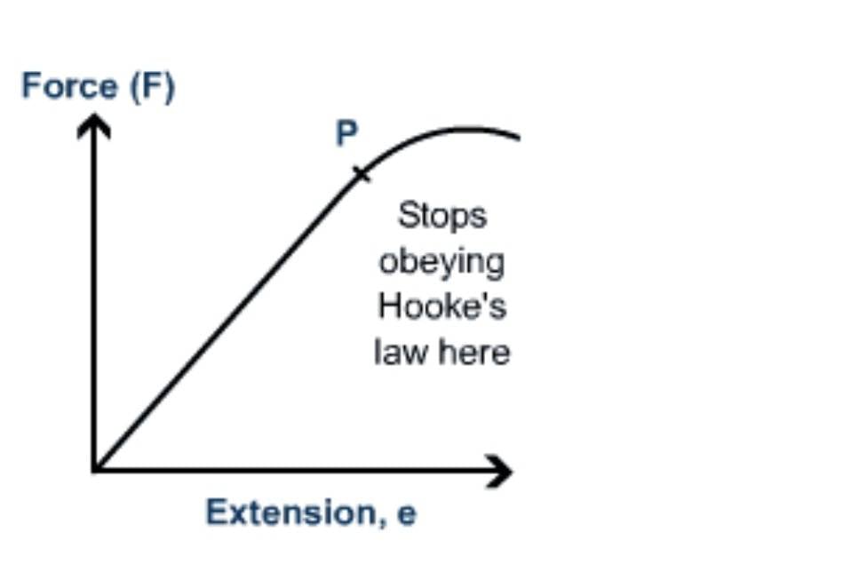

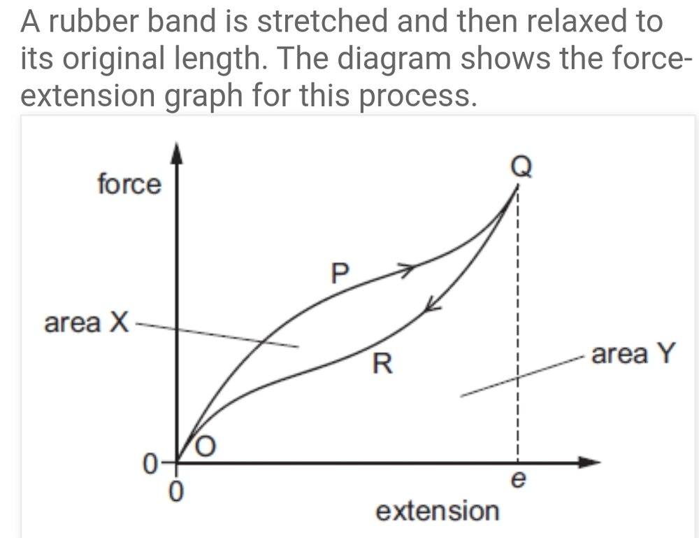

Thank you for the reply.
I understand how the force extention graphs for rubber band and spring are.
I've attached them here.
I know that reloading spring is different before and after it passes the linear part.
But I cannot still answer the question.
You are still not addressing the question. Contrast the compressive properties of rubber versus metal springs. Please do that now.
Also, the question asks about a material that is not springy at all. What are your thoughts about that part?

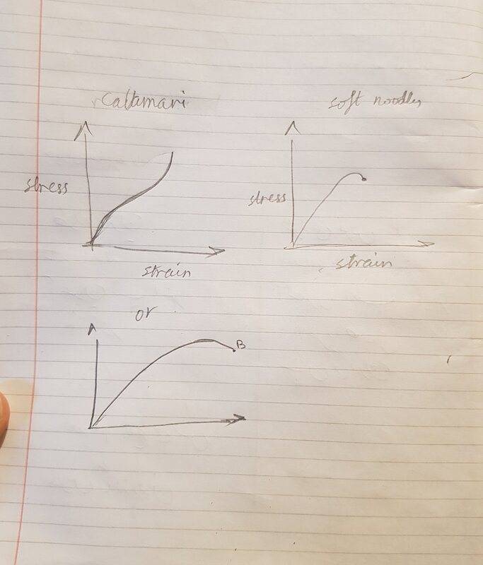

I would say the noodles break with a lot less force which means the stress strain graph is much lower . For both graphs we have the same shape that we have for rubber band which is a none linear graph. I've attached the loading reloading graph for you. Both soft noodles and calamari squid have similar shape graph as rubber band.
Am I correct ?
For the calamari, that is sort of right, but you are supposed to be considering biting into it, not pulling it, so the axis should be compression, not extension. Also, it is important to show the failure trajectory, where the bite does irreparable damage to the morsel. What happens to the resistive force in this case?
For the soft noodles, one key difference is that the elastic range is so short as to be almost nonexistent. Another is how the resistance varies (or doesn't) once plastic phase is reached.

I'd need to see your actual graphs to comment on them.
The rubberiness of calamari means it has a greater elastic range of deformation.
But the other distinction I would make is in regards to what happens once it starts to yield. As you bite into calamari, does the resistance rise to a maximum and stay there? What about soft noodles?

I think for the soft noodles , reaches to a maximum and then quickly breaks. for the calamari reaches to a maximum but it will still carry on deforming since it has plastic deformation. I am not very sure about the graphs though. I have attached what i think should be close.

I would have said the resistance from soft noodles quickly reaches a (low) maximum and stays there. Its deformation is plastic almost from the start, so the force it exerts on your teeth drops to zero as soon as you stop biting.
The calamari has a much longer elastic phase, but once your teeth have started to go through it I believe it will break quite quickly, the resistance falling away.
Thank you very much.
So in a few words I can say that the behaviour of soft noodles is plastic whereas the behaviour of Calamari is elastic. Plus calamari is strong but soft noodles are weak . Is this corect ? Or should I use other terms instead of strong and weak?

That is all reasonable.
