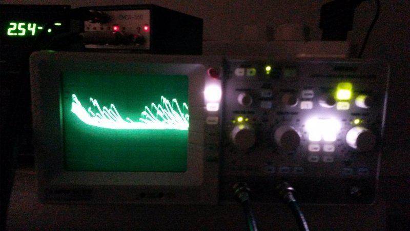

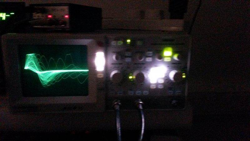

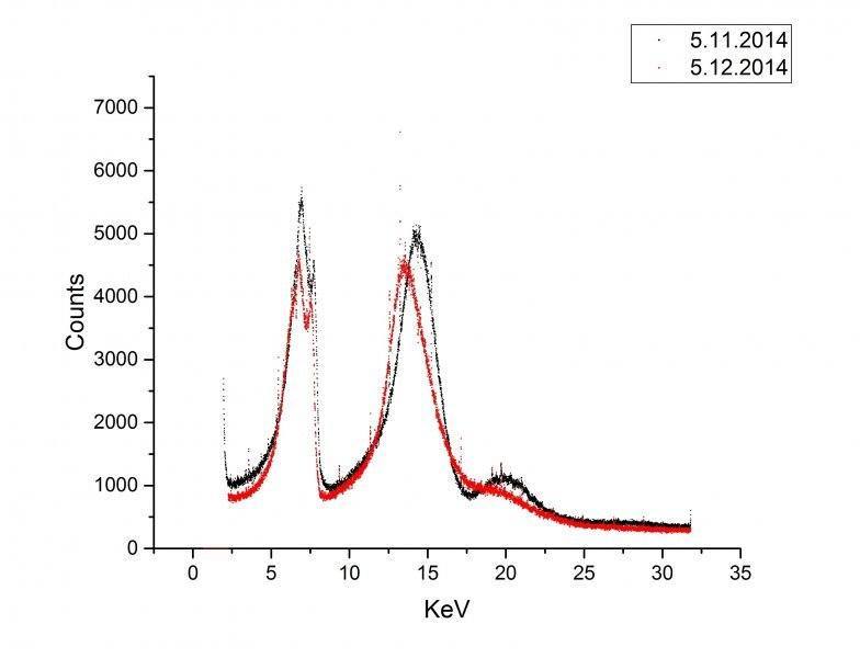

Hi guys. I have a problem with my spectrum and I would like your help. I have a system with a proportional Gas detector (krypton gas), preamplifier and amplifier, Co57 source, and the last two months the spectrum has gotten worst as you can see in the attachment. Does anyone know what might be the problem? Detector? Preamplifier? Unfortunately I don't have spare parts so I can't eliminate something.
The last two pictures are the output signal from the preamplifier, and the amplifier

This obviously depends on how much you've used it, but how's the gas circulation in the counter?
To me, it looks like the FWHM of the peaks is pretty much the same, ditto the relative heights of the peaks. Were the spectra taken for the same time (accounting for a little 57Co decay)? It just looks like you've just lost a little gain? Is this spectrum actually unusable to you?

Yes the spectra was taken for the same time, the difference from the decay should be very small. The detector is a "closed can" style, so there is no gas circulation. The spectrum is not unusable but its not perfect. I must use the counts from the 14keV peak, for Mossbauer experiments, and the "non 14keV" i take into account are extra noise so it creates a little problem.
The thing that annoys me, is that the peak at 6 keV remained perfect. an the other two are problematic.
It seems to me that the difference due to decay in one month should be about 8%. (The halflife of 57Co is only 272 days, after all). But that's probably not the only problem. I'm assuming you've kept the geometry constant as well.
I asked about gas flow because you do expect that closed-can type proportional counters will degrade over time due to deposition.
It's hard to tell without being there, obviously, and it's hard to tell without being able to swap out components. I'd be taking away the source, and looking at what the scope is triggering on - are you picking up any RF? If you move around the amplifier/preamp/cables, does the noise change?
ETA: Another thought: How's the power supply? Has your leakage current gone substantially up?

I changed the cables completely, the power supply is ok. I even tried it with 1500-1800 V (it was 1700 originally). Without source, its just little random noise. Geometry is constant. I also removed the cryostat, shielding and collimator. At first. I though it was x ray fluorescence from something.
It looks to me that it actually split the main peaks in two, with the second one in little less energy. Maybe the ions can't move and be collected fast enough so they create an electric field that "reduce" the next avalanche and the measured energy from the next photon.
