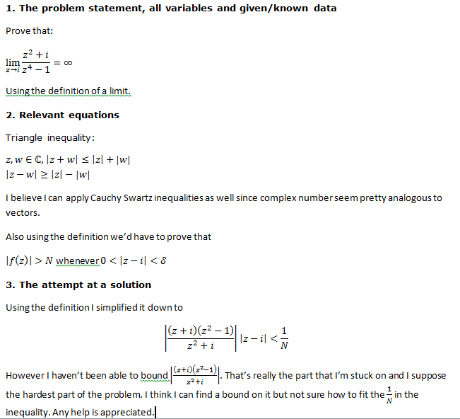

Prove lim z->i ((z^2+i)/(z^4-1))=∞

I wasn't 100% sure of how proving that limit equals zero would help but I did take your advice and broke the problem into several limits whose products are infinity.
SammyS said:
thed0ctor,
See what bound [itex]\displaystyle \left|z-i\right|<\frac{1}{2}[/itex] puts on [itex]\displaystyle \left|\frac{(z + i)(z^2 - 1)}{z^2 + i}\right|\ .[/itex]
I used the idea of bounding |z+i| by 3 by assuming delta was at most 1. I attached a pdf of my work. If someone could check it to make sure my logic is alright I'd be very grateful. I've just recently found out how epsilon and deltas work.

Good point. I also believe I found a bound. it's a nasty number but it's off the assumption that |z-i|< δ< .5
I attached the pdf. I think I'm getting better with inequalities. Thanks so much for your help thus far!
I just skimmed through your PDF and I think I found a problem.
You established that [itex]|z^2 + i| < 11/2[/itex] but then you applied this with [itex]|z^2 + i|[/itex] in the denominator. In that case, you need to reverse the inequality:
[tex]\frac{1}{|z^2 + i|} > \frac{1}{11/2}[/tex]
Therefore your final inequality is not correct.
If you want an upper bound for [itex]1/|z^2 + i|[/itex], then you need a LOWER bound for [itex]|z^2 + i|[/itex].
By the way, here's what I was getting at earlier in message #3. Suppose you have proved that
[tex]\lim_{z \rightarrow i} \frac{z^4 - 1}{z^2 + i} = 0[/tex]
Then this means, by definition, that given N > 0 there exists [itex]\delta > 0[/itex] such that
[tex]\left| \frac{z^4 - 1}{z^2 + i} \right| < \frac{1}{N}[/tex]
whenever [itex]0 < |z - i| < \delta[/itex]. But that's exactly what you need, right? (Just take the reciprocal of the above inequality.) Therefore the problem reduces to showing that
and you can do this quite simply by using the algebra of limits (i.e., the limit of the quotient is the quotient of the limits), instead of playing around with all these inequalities.
Of course, if your instructor intends for you to do a full delta-epsilon proof for everything, then you should carry on doing that. It's hard to tell from the problem statement.
