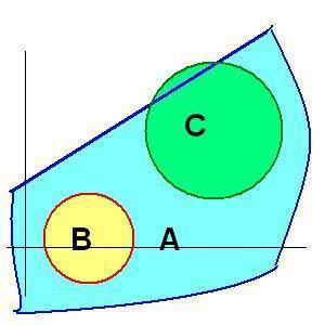

First answer to Curious question first: What is a subset? What is a proper subset?
Is B a subset of A in the drawing? Is it a proper subset? Is C a subset of A?
ehild

Ehild, you lost me completely. This topic is fairly new to me so I will be happy to have bit more explanation. If you could expand or give an example that be great.
C is not a proper subset of a as part of C lies outside A however B is a proper subset as all of b lies within A
How your problem looks like? What part of C lies outside A? How can you specify it?
How can you formulate that all points b lie within A?
ehild
Centre of the circle is (2,-1)in this case so if you take the point x=2 & y=-1 plug it in the y-2x<2 ten it is true.
Any good?
Yes, the centre of the circle belongs to A. B means those points which are closer to point (2,-1) than r=3. To be not element of A the distance of a point from (2,1) should be greater than the shortest distance of the border line of A. What is the shortest distance of the line from the centre of the circle?
