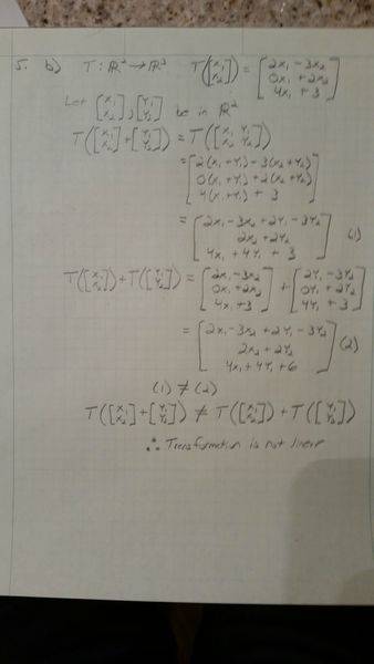

If T is linear, show that it is linear by finding a standard matrix A for T so that:
Also show that this equation holds for the matrix you have found. If T is not linear, prove that T is not linear by showing that it does not fit the definition of a linear transformation
Definition of a linear transformation:
[itex]T(\vec{u}+\vec{v}) = T(\vec{u})+T(\vec{v})[/itex]
[itex]T(c\vec{u}) = cT(\vec{u})[/itex]

However, when I go to separate
\vec{b} = \begin{bmatrix}
2x_1 - 3x_2\\
2x_2\\
4x_1 + 3
\end{bmatrix}$$ I am not sure how to handle the constant, i.e, I am not sure how to rewrite as [itex]A\vec{x}[/itex]. I think once I figure that out I should be able to do the rest of problem
It is not linear ... Just find a counter example to the definitions of what a linear transformation is.
(Edit : deleted, duplicate response)
Ok, I didn't realize that was all I needed to do. I have attached a picture of my work because it would be kind of long to write out in latex:
You could simplify that a lot. If T is linear, then T(0)=0, since T(0x)=0T(x). Is it for your given T?
wow I hadn't thought of that, sort of makes the problem trivial lol...anyway thanks for the help :)
